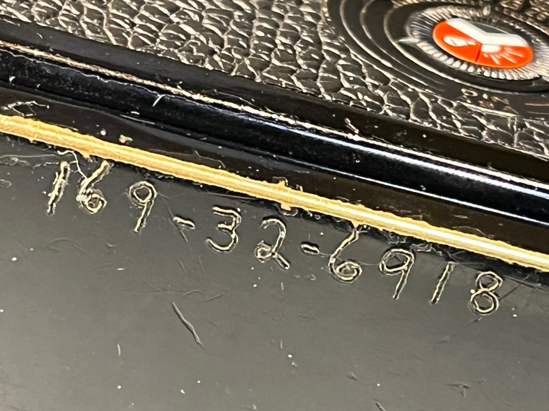

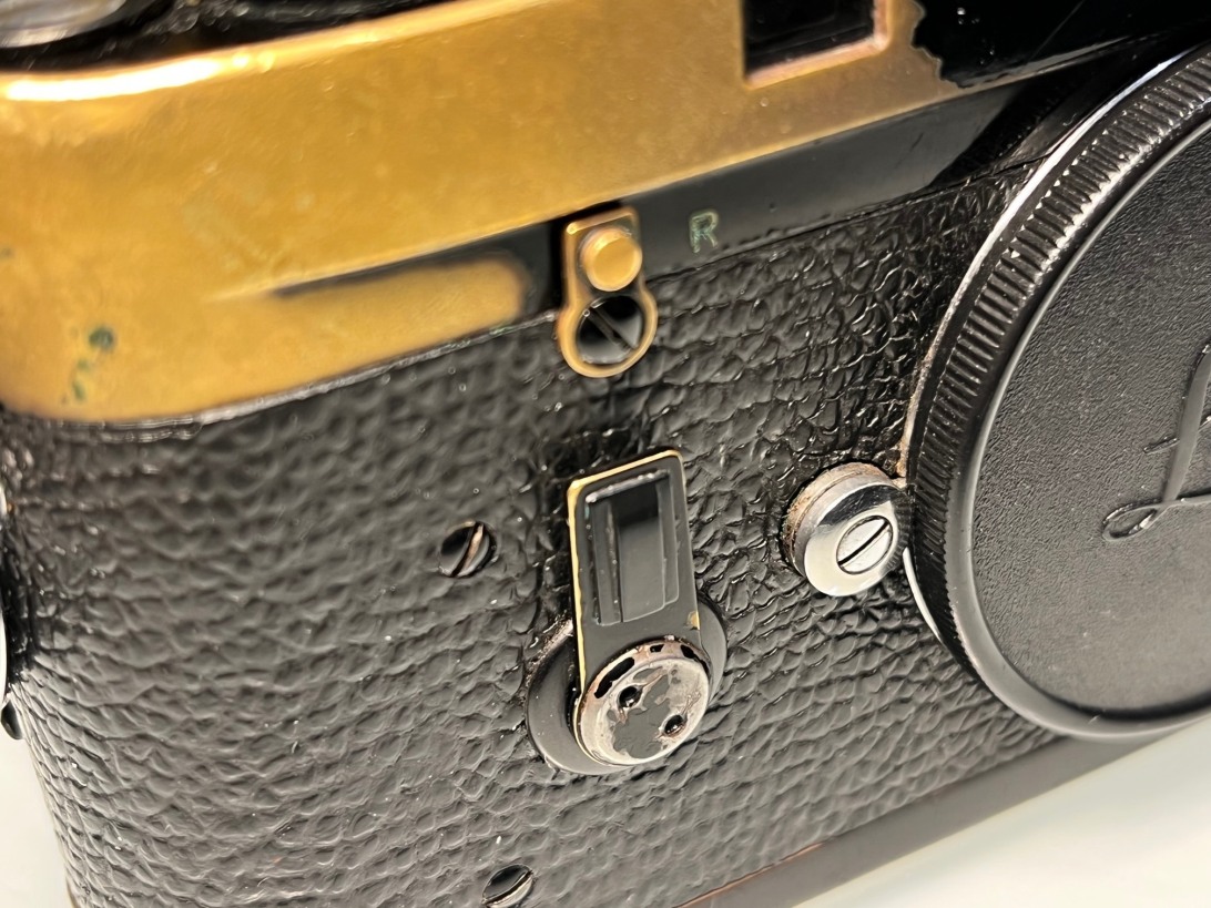

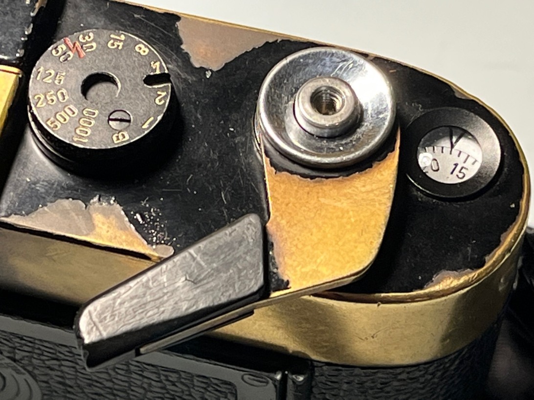

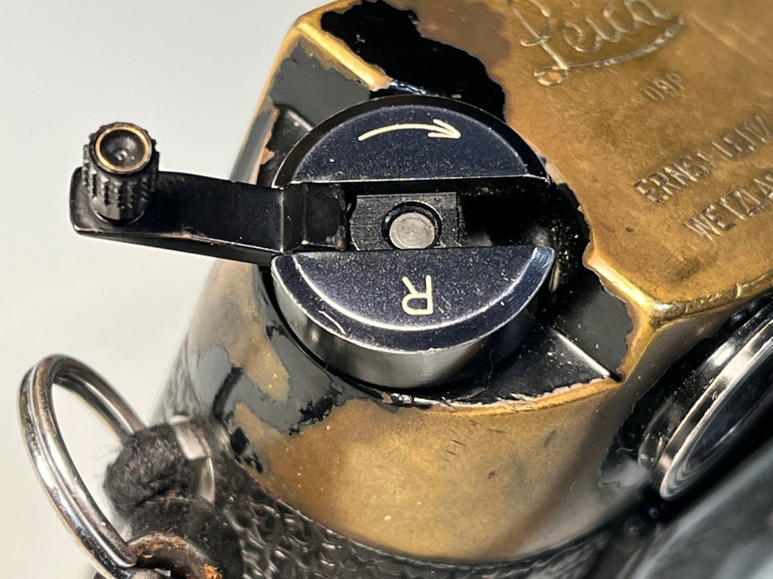

jcraf Posted January 1, 2016 Share #1  Posted January 1, 2016 Advertisement (gone after registration) In an idle and perhaps paranoid moment, I have been trying to find out some information about my M4 Black paint.  The serial number is 1 181 922, dating it to 1967 and the first batch of BP M4 cameras (?). A similar camera, number 1 181 693, appears in van Hasbroeck's book (plate 121, p176). Additionally Stephen Gandy's Cameraquest 'list' puts both cameras the first batch of BP M4s.  The camera is brassing nicely and on the vulcanite below the frame selector has a small square gold and black stylized badge which includes the words 'Cattaneo' and 'Importer'. I understand that Cattaneo was an Italian Leica importer for some years. The badge is stuck fast to the vulcanite. The camera has four black screws in the hotshoe which I understand was found on these early black paint cameras. It appears to my eyes that the 'L' seal is intact.  So, a 1967 BP M4 by all reasonable reckoning?  Trouble is, I made the mistake of asking Wetzlar to confirm and thus far they have said 'Chrome'......they have requested photos but thus far have not come back.  I bought the camera for a very reasonable price, and I love using it, so even it is not genuine it gives me pleasure!  Any advice gratefully received!! I can PM photos if required. Link to post Share on other sites More sharing options...

duckrider Posted January 2, 2016 Share #16 Â Posted January 2, 2016 To my eyes the "Ernst Leitz..." engravings look as (well done) repaint. Black colour around the engraving seems too thick. I did own a repaint M2 some yrs. ago looking similar. Thomas 5 Link to post Share on other sites More sharing options...
sumolux Posted January 2, 2016 Share #17  Posted January 2, 2016 To my eyes the "Ernst Leitz..." engravings look as (well done) repaint. Black colour around the engraving seems too thick. I did own a repaint M2 some yrs. ago looking similar. Thomas   Yes, same experience and feeling here. Could also just be a 'bad paint day', but it looks strange.  Also, on the front it looks almost like brushstrokes here and there, but this could be surface dirt? Or perhaps all these things could be the result of re-touching the existing (black) paint? 1 Link to post Share on other sites More sharing options...

Bill Livingston Posted January 2, 2016 Share #19 Â Posted January 2, 2016 It looks like a repainted M4 to me too... the paint just doesn't look right. Too think and too uneven in both cover and reflectivity, particularly on the rewind knob and the top plate. It doesn't look naturally brassed either. It looks as though what little black paint has worn, has allowed the underlying chrome to show through... you have to go through that, and its quite heard wearing, before you see the underlying brass... So almost everything points to a repainted camera to me... although there is one way to find out for certain. Â You could always send it to Wetzlar for a CLA and a full inspection... 1 Link to post Share on other sites More sharing options...
jcraf Posted January 2, 2016 Author Share #20  Posted January 2, 2016 It looks like a repainted M4 to me too... the paint just doesn't look right. Too think and too uneven in both cover and reflectivity, particularly on the rewind knob and the top plate. It doesn't look naturally brassed either. It looks as though what little black paint has worn, has allowed the underlying chrome to show through... you have to go through that, and its quite heard wearing, before you see the underlying brass... So almost everything points to a repainted camera to me... although there is one way to find out for certain.  You could always send it to Wetzlar for a CLA and a full inspection...  Thanks all. I can't see any chrome on the camera, only brassing showing through the paint wear. Most noticeable on the crank, counter window and edge of the winder lever. Which means that if it's a chrome to BP repaint the chrome would need to have been removed. I am unsure whether this is routinely done/required on BP repaints - presumably it adds to the cost.  Strangely enough the paint on the top plate looks thick and uneven in the photo and yet is quite smooth and even in the flesh, so to speak. You can perhaps see this better in the oblique view from the crank end.  A similar uneven effect is seen in Laney's tome in a photo of a BP M4-M, around the white script on the top plate.  The other 'brush' artefacts that are mentioned are indeed just down surface dirt, greasy fingermarks in fact (mea culpa).  I am still left with mystery of the Cameraquest BP batch numbers (sourced via Leica), and the van Hasebroeck camera, proximal in number to mine.  To me it feels right somehow.  I'll wait and see what Wetzlar says.  Whatever happens, it's a nice camera and of all of the many Ms I have owned, it feels and shoots the best. And financially speaking, we're hardly verifying the identity of a Picasso, just satisfying curiosity!  Regards 2 Link to post Share on other sites More sharing options...
