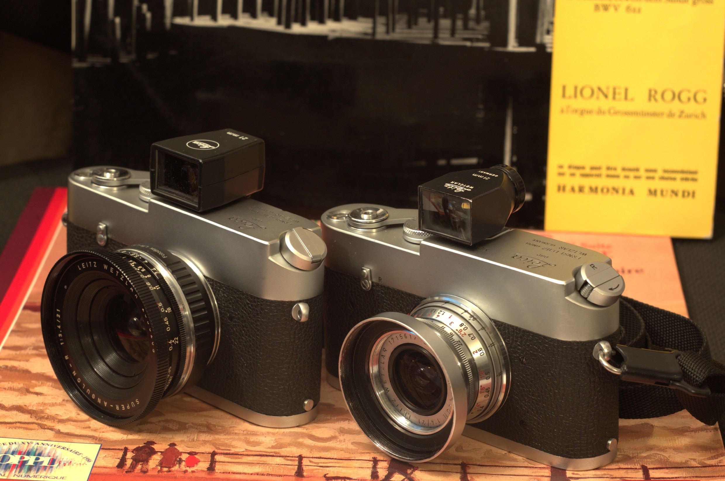

On 9/6/2025 at 10:22 AM, wlaidlaw said:
21/f4 Super Angulon - R
Just for fun ;)
size comparison R/M "same lens" ...
59 minutes ago, a.noctilux said:
Just for fun ;)
No rangefinder? Those cannot be M cameras then :D Just kidding. BTW may i ask what hood you were using on this M 21/4?
Noname hood.
Many years back, I went to Bièvres , Rencontres photos, every year early June, my favorite pastime.
I went there with the lens, then took time to find the hood (with many things, of course) with a sheet of paper with a list and measurements of the bit I was after.
The hood has no reference or marking, sorry.
It mounts from the outside of the lens by friction, 42mm.
No vignetting at all.
