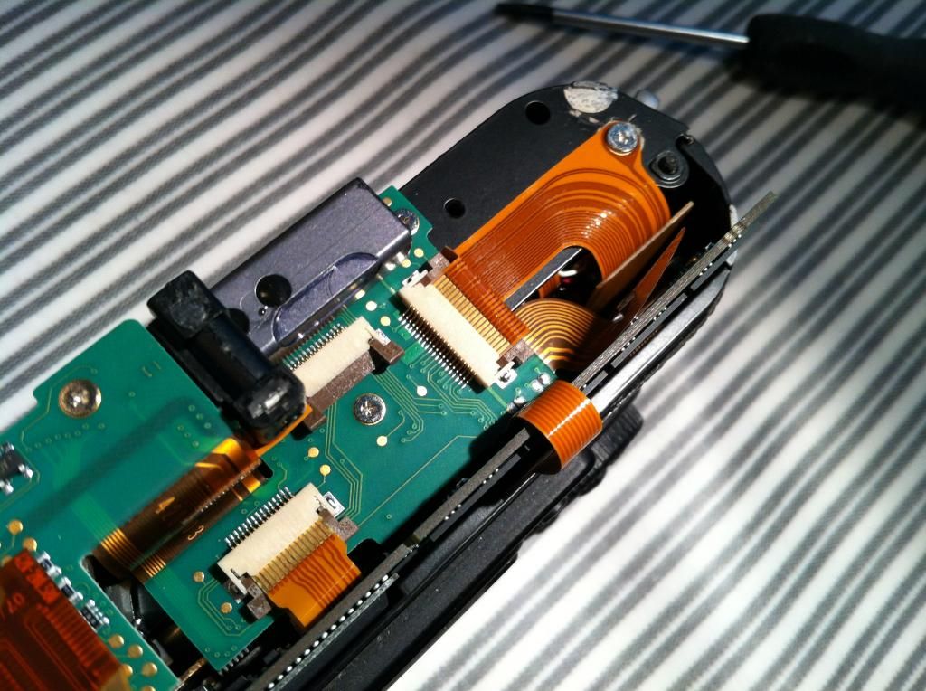

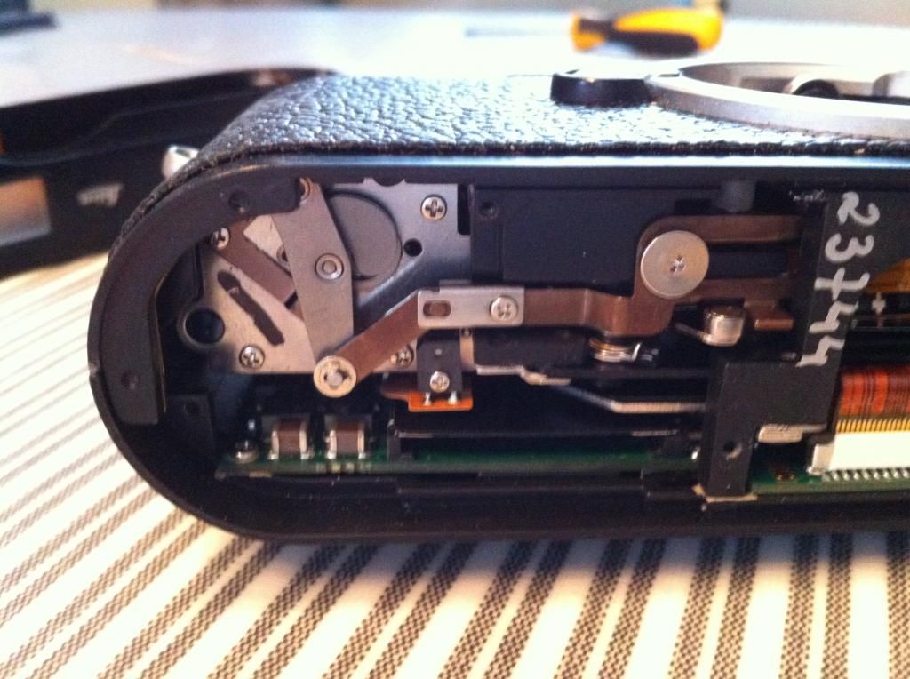

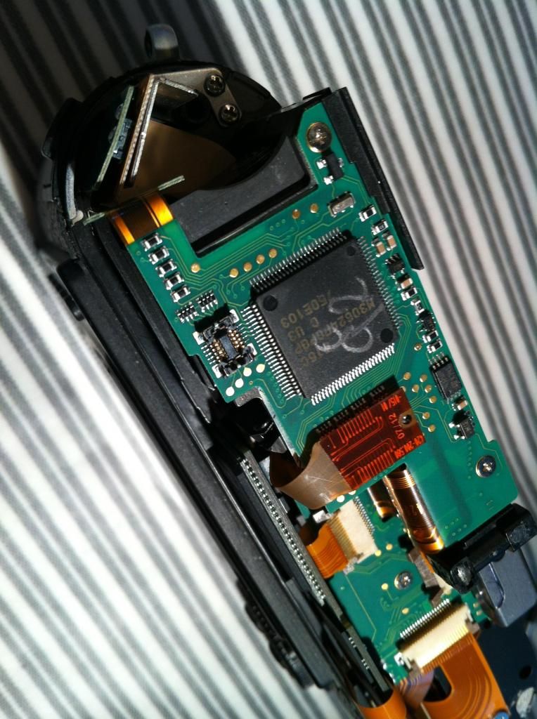

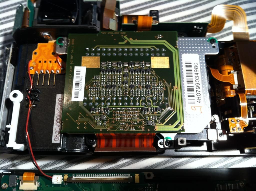

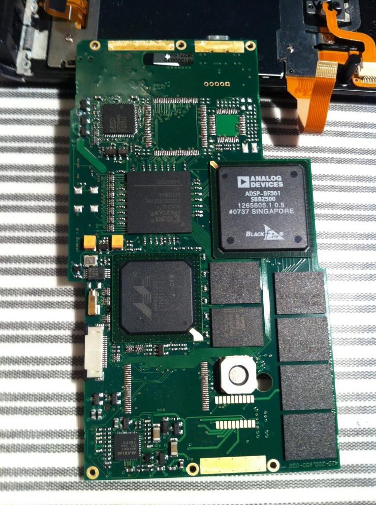

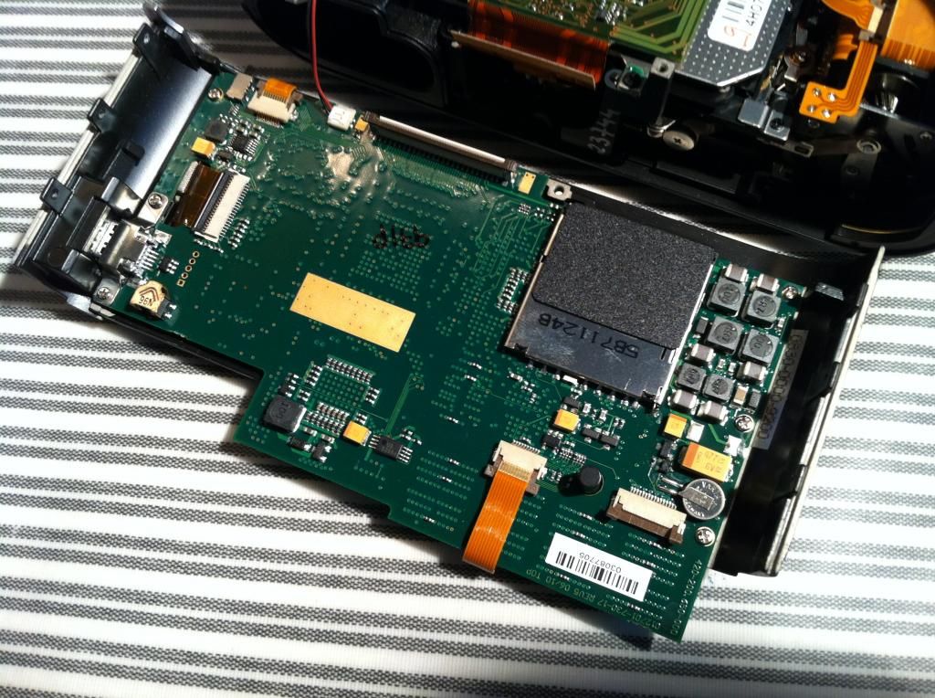

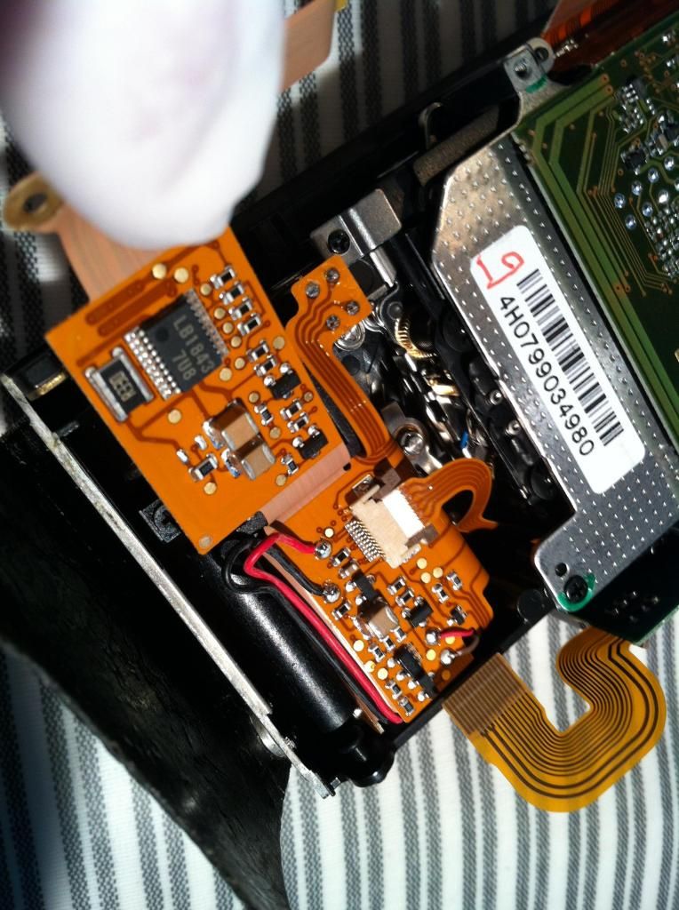

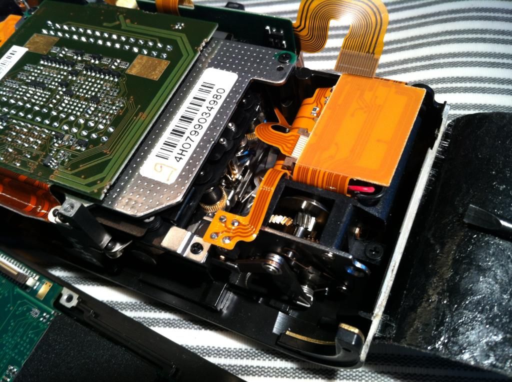

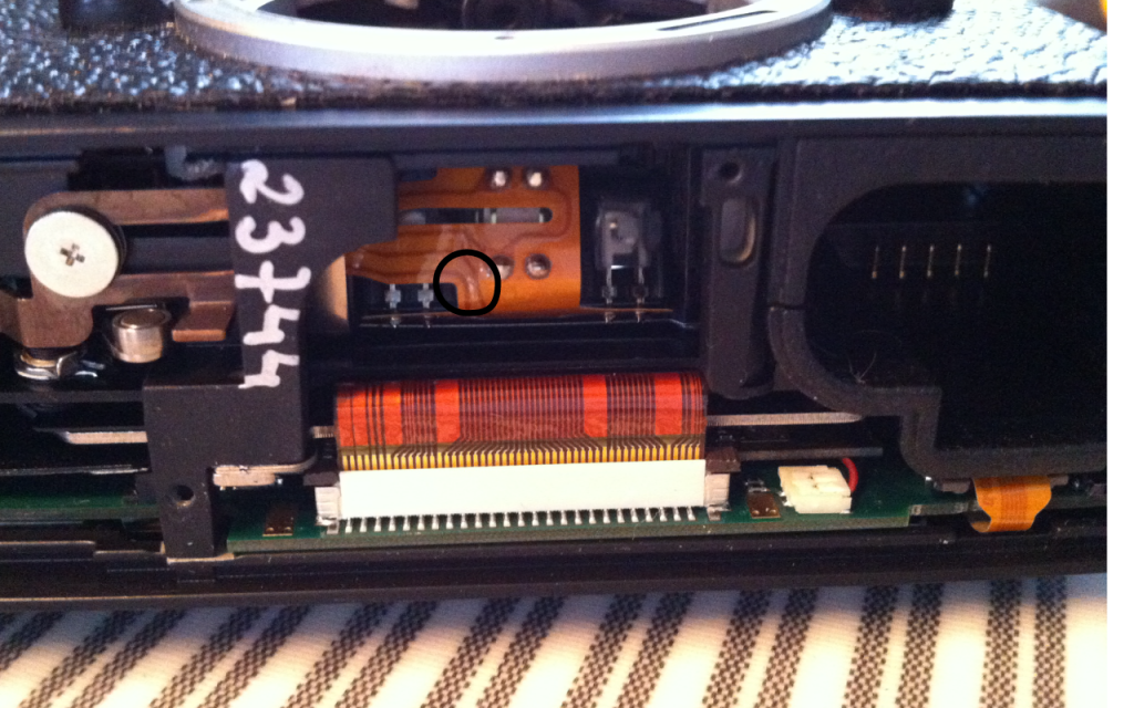

Ok. I've already manage to take it apart, and to me, it looks pretty darn clean. The only thing I found was on the board in front of the screen, where the ground(?) connectors are to the backside of the camera. See in the top of second to last photo. Though I can't see how this could ruin it. Plus a tiny white spot on a brown wire (flat) under the camera (see pic with black circle. How ever, it doesn't seem to touch the actual leaders.

Two weeks ago I repaired a water damaged Sony NEX-6 which has travelled from Thailand to Turkey over two weeks after I scored it over eBay. I don't know how long it waited after damage. It was dry when arrived. :) There were several corrosion marks on many flex cables and circuit boards and magnesium body parts (nastiest). The first thing I checked were the fuses. They were fine. Then I used used a toothbrush and distilled water to clean all boards, connectors and the body parts. Then I used hot air gun to evaporate the wetness. Then I washed all parts with pure isopropyl alcohol. Again hot air. Then I put it together. Result? Perfect! :)
I have checked the photos you put over here. The IMG_0798 may have signs of corrosion on top left edge of the circuit board, between 3 power transistors. Otherwise the rest is very clean. You would be shocked if you saw the NEX-6 I repaired, sadly no photos.
I think you got yourself a steal. If you focus on the point I suggested above and make sure all connectors are cleaned with alcohol, it should work. If you can't bring it to life, sell it to me for 100 bucks! :)
Good luck!
Good luck!
K.
PS: By the way I repaired another water damaged DSLR (a canon 30D) many years ago. Sure, most water damaged electronics are beyond economical repair, but some can be done.
This looks really, really encouraging.
I would try a freshly charged battery when you get one and cross your fingers, eyes, and toes.
If it is still DOA I would send it to Leica for an estimate.
