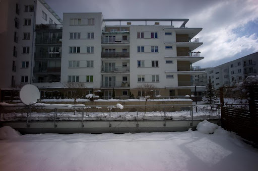

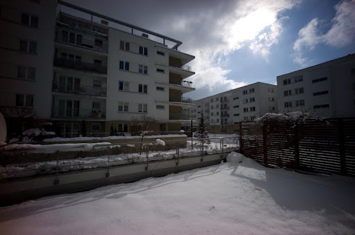

Jerry_R Posted March 16, 2010 Share #217 Posted March 16, 2010 CV 15mm examples, uncoded and coded as 28mm f/2, new firmware. Yesterday I was quite enthusiastic when saw results inside an apartment. Today morning I took few shots outside. Left and bottom part becomes better (but still shift is visible), but top and right part becomes worse...Blue sky is gone. And even like new shift would appear... Have a look. I think still Corner Fix is a solution. These are RAWs just opened in LR and exported as JPGs. No vignetting applied. I planned to buy WATE, but if I would still have to use Corner Fix for such money, I will wait. Tomorrow I will get 24mm f/3.8, so can test it too. CV 15mm @4.5 (uncoded) CV 15mm @4.5 (coded as 28mm f/2) CV 15mm @4.5 (uncoded) CV 15mm @4.5 (coded as 28mm f/2) Link to post Share on other sites More sharing options...

Alnitak Posted March 16, 2010 Share #220 Posted March 16, 2010 CV 15mm examples, uncoded and coded as 28mm f/2, new firmware. Yesterday I was quite enthusiastic when saw results inside an apartment. Today morning I took few shots outside. Left and bottom part becomes better (but still shift is visible), but top and right part becomes worse...Blue sky is gone. And even like new shift would appear... Have a look. I think still Corner Fix is a solution. These are RAWs just opened in LR and exported as JPGs. No vignetting applied. I planned to buy WATE, but if I would still have to use Corner Fix for such money, I will wait. Tomorrow I will get 24mm f/3.8, so can test it too. Jerry, The red edges seem to generally be the exception with the WATE, and even in the worst examples I have seen posted, they are nowhere near as bad as the CV15. I would suggest trying one out on your M9 to see what you think. My bet is that you don't find any red edge issues. Jeff Link to post Share on other sites More sharing options...
