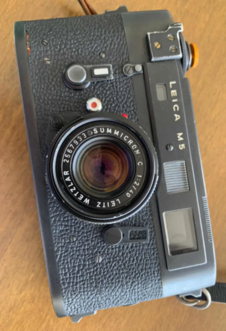

  2. Hello everybody, I currently have a Leica M2 and now I've been looking into the M5. I stumbled upon one for sale in my country, but I noticed in its photos that this particular camera has a strange metal part/piece in the front of the camera, right bellow the shutter speed selector. I asked the seller about it but he said he bought it like that and has no clue about what it is, he said he thinks it may be a support of some sort. I really don't know, but maybe it is something adapted there to prevent the user to change the shutter speed by accident? Just wondering about it. Apart from that, the camera is said to be working completlely fine. Has anyone ever seen something like this? Any guesses are welcome. Thanks in advance!
