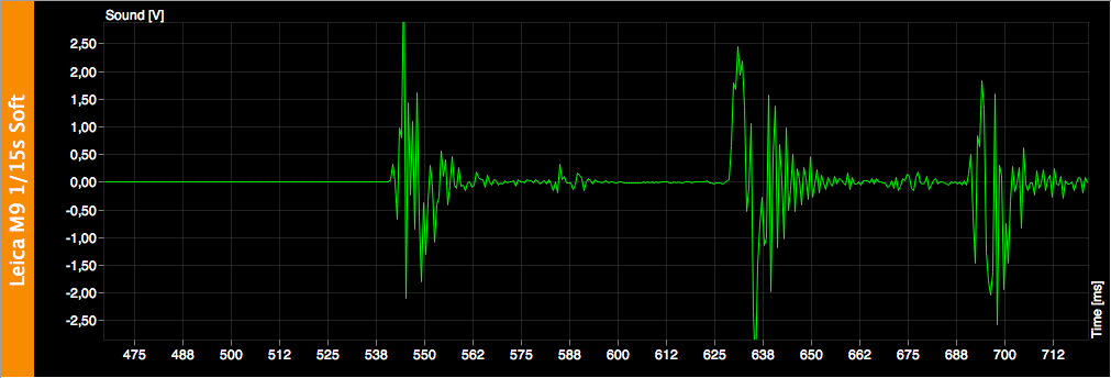

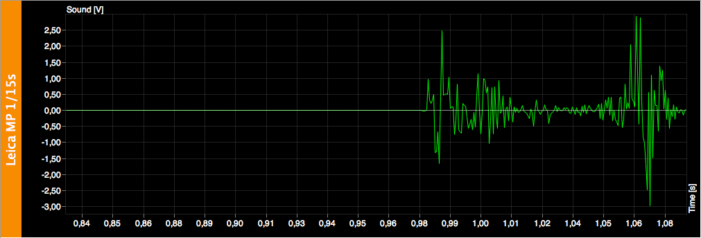

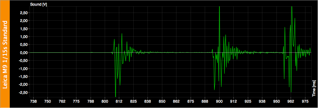

SJP Posted February 18, 2011 Share #302 Posted February 18, 2011 You can also establish shutter lag with sound. Here two releases of the M9, one with 1/60 sec. (top panel) and one with 1/30 sec. (bottom panel) shutter time, sampled at 44.100 Hz. The first burst of sound happens right when pressing the button. Then there is a 0.09 second silence and the first curtain starts to travel, shown by the second burst. The third burst is the sound of travel of the second curtain, closing off the sensor. Remarkable how similar the sound waves are due to the exact way the mechanism of the shutter is operated. Every time the same way. Nice test! My compliments. How did you determine the start/end times & how did you get such a high sound level for pressing the shutter? If you start from first contact you get 1.257 to 1.345 in the first picture and 0.880 to 0.965 in the second giving a lag of 0.088 and 0.085 respectively, so 0.0865 s average lag. On the other hand, if we asume that the actual time of "full detent" of the shutter release button i.e. after half-detent and locking of exposure/shutter time etc. is the point of reference then the time becomes about 0.015s shorter, ie. 0.0715 s. This is still surprisingly longer than the timer applet suggests for my M8, I might check this myself when I get it back. Could it be that the shutter delay is related to emptying of a buffer before actuating the curtains? If that is the case the M8 would be roughly 2x faster than the M9 (due to 18/10.1 Mpix ratio). Link to post Share on other sites More sharing options...

mby Posted February 18, 2011 Share #304 Posted February 18, 2011 You can also establish shutter lag with sound. Here two releases of the M9, one with 1/60 sec. (top panel) and one with 1/30 sec. (bottom panel) shutter time, sampled at 44.100 Hz. The first burst of sound happens right when pressing the button. Then there is a 0.09 second silence and the first curtain starts to travel, shown by the second burst. The third burst is the sound of travel of the second curtain, closing off the sensor. Remarkable how similar the sound waves are due to the exact way the mechanism of the shutter is operated. Every time the same way. (...) Based on Bert's terrific idea and work, here's a comparison with MP and M9: Leica MP 1/15s: Leica M9 1/15s Standard Mode: Leica M9 1/15s Soft Mode: Best regards, Michael Link to post Share on other sites More sharing options...
