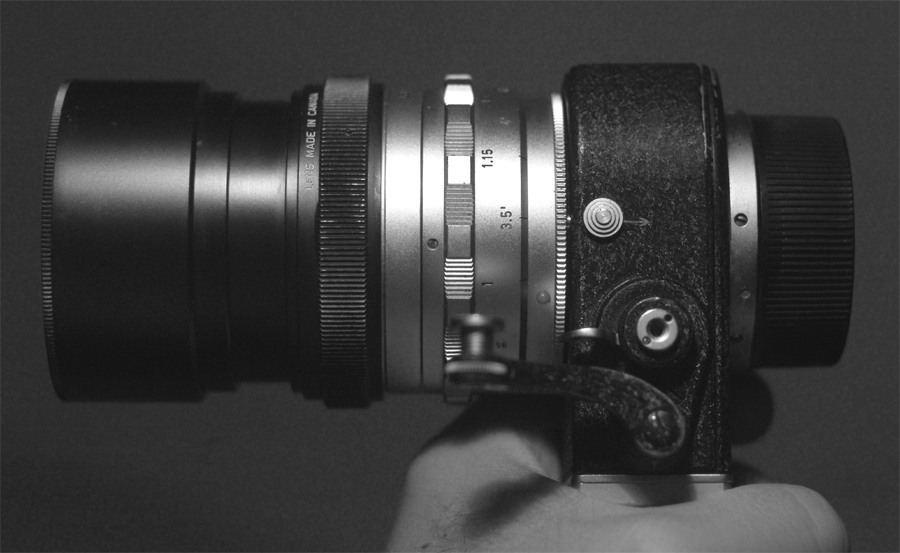

luigi bertolotti Posted October 6, 2008 Share #13 Posted October 6, 2008 Here is my M8 with Visoflex II and "chimney finder" : lens is a Tele Elmar 135 lenshead with focusing unit and extender tube - a good and easy to use macro set Welcome, dear visitor! As registered member you'd see an image here… Simply register for free here – We are always happy to welcome new members! Taken with a Nokia Camera... Link to post Share on other sites Simply register for free here – We are always happy to welcome new members! Taken with a Nokia Camera... ' data-webShareUrl='https://www.l-camera-forum.com/topic/64583-visoflex-on-m8/?do=findComment&comment=676674'>More sharing options...

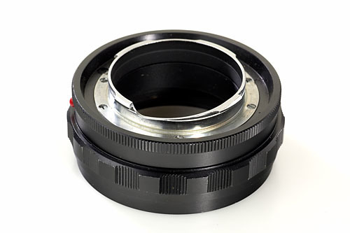

luigi bertolotti Posted October 6, 2008 Share #18 Posted October 6, 2008 Hi JC, Well, the front of my 135mm Elmarit unscrews and it can be mounted on a focus mount Leica designed for this lens and the 90mm Summicron for use on any Visoflex. I bought the visoflex 2 because it only cost me $60 US dollars on Ebay. I thought it was a good buy in that other units were well above $200 and more, especially the Visoflex 3. So you think to setup the combo hereunder described... well, I have the 2 rings (helical focusing mount + addon macro adapter) : indeed it works well, but not so quick in operation. (The attached page refers to Viso III, but with the II is exactly the same). Welcome, dear visitor! As registered member you'd see an image here… Simply register for free here – We are always happy to welcome new members! btw, the two rings, as always, are much more funny to be identified with the old 5-letters codes... ZOOEP and OUEPO... Link to post Share on other sites Simply register for free here – We are always happy to welcome new members! btw, the two rings, as always, are much more funny to be identified with the old 5-letters codes... ZOOEP and OUEPO... ' data-webShareUrl='https://www.l-camera-forum.com/topic/64583-visoflex-on-m8/?do=findComment&comment=677169'>More sharing options...
