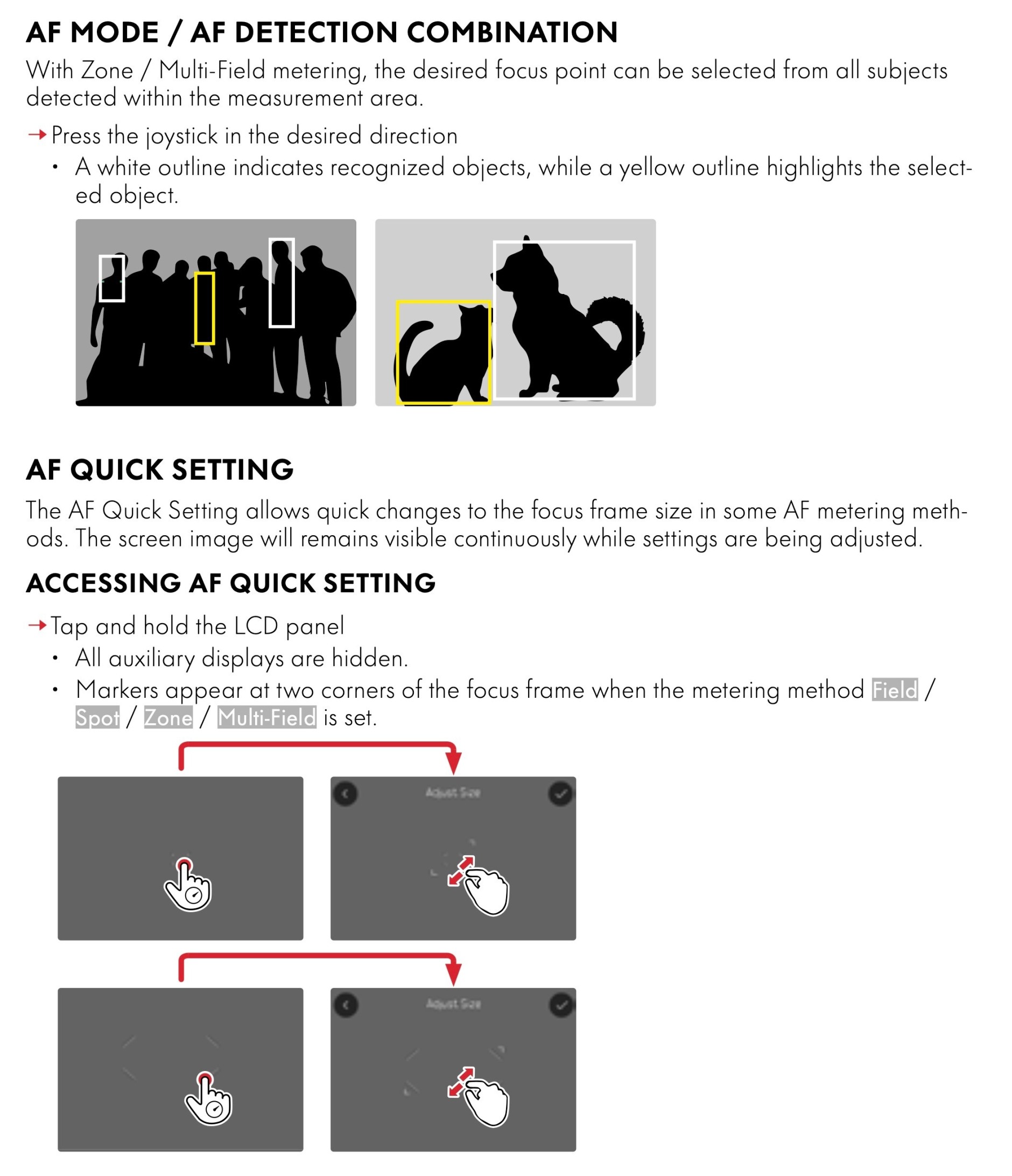

Consolidating AF Mode - what are they thinking??
Especially for people using the SL3's out in weather, instead of using a single camera function to switch between all AF Modes, photographers now need to go into the menu, switch to a basic AF Mode, exit menu, move the camera away from their face, then take their gloves off (for example folks shooting in cold weather), engage the LCD screen, manually manipulate the basic AF Mode to switch between sub-modes of the base AF mode, manually select the sub-mode, put their glove back on, put the camera back to their face, and then continue with shooting their subject.
How does that make any sense at all?  Is all that time and effort better than scrolling through 3 versus 5 AF modes in the menu?
Beyond that, while I have not had time for RL testing yet, inside the house testing on both SL3 and SL3-S
- AF doesn't feel snappier that prior tests
- Tracking bounces around and loses stickiness
- Tracking AF Mode cannot be used with Human/Animal detection modes, which means the user needs to change TWO options (AF Mode and AF Detection) to switch between tracking a subject versus face/eye/body detection
- Eye/face/body detection only seems to work well when faces/bodies are near/within the AF Mode spot/bracket
I look forward to testing all this out in the real world, as AF performance improvements on the SL3 is something I felt was horribly underwhelming for an $8k+ camera body and have been hoping for now for years, but so far indoors I am not impressed (though, hopefully, I will be happily proven wrong).
