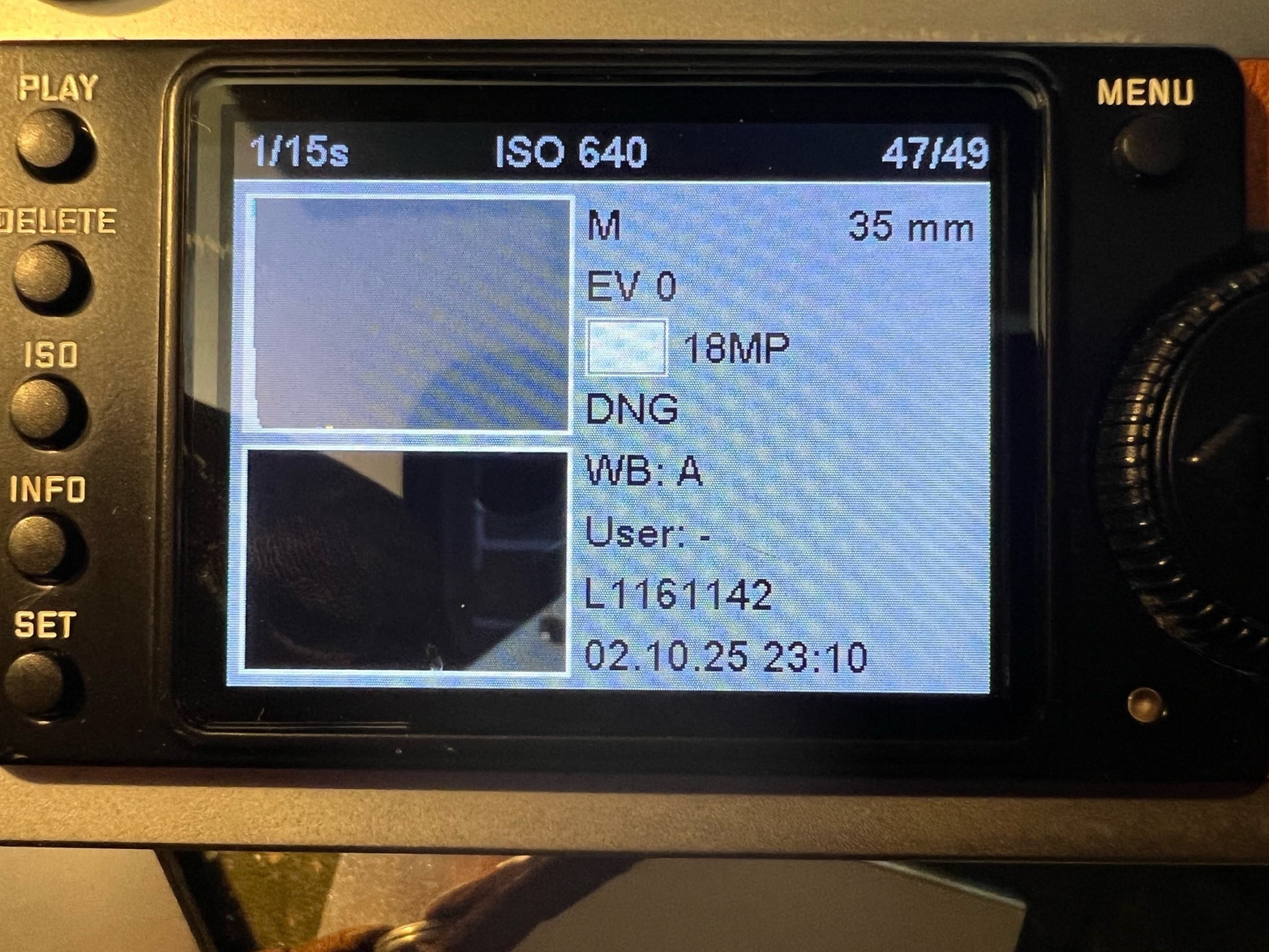

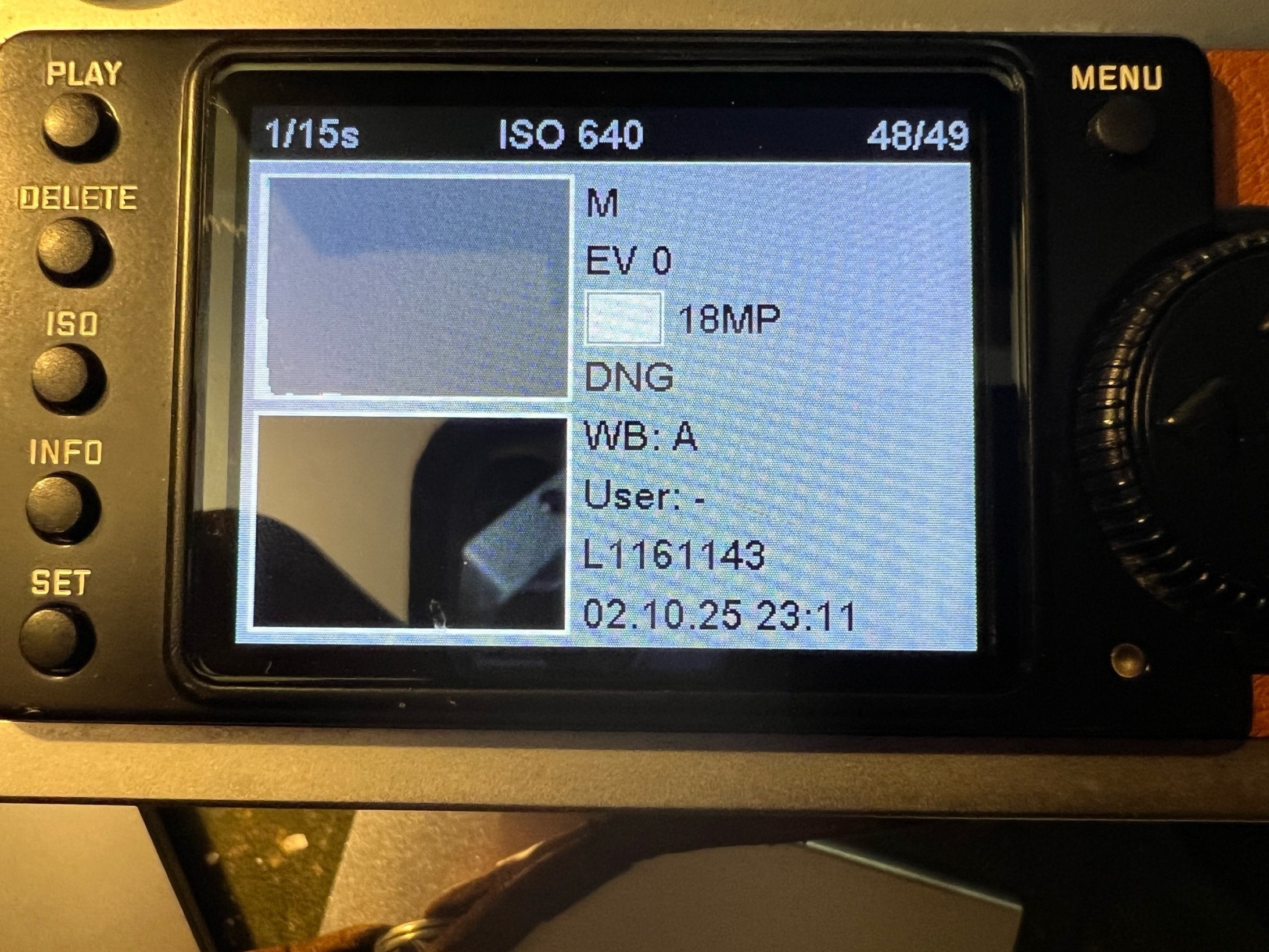

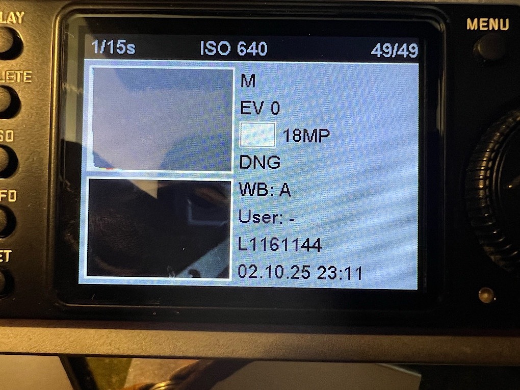

lct Posted October 10 Author Share #162 Posted October 10 Exif data are self explanatory: • Tri-Elmar-M 1:4/28-35-50 ASPH. @ 35mm • Tri-Elmar-M 1:4/28-35-50 ASPH. @ 50mm • Tri-Elmar-M 1:4/28-35-50 ASPH. @ 28mm Being a lens i use mainly with EVF, i will keep it without spring for now. Link to post Share on other sites More sharing options...
