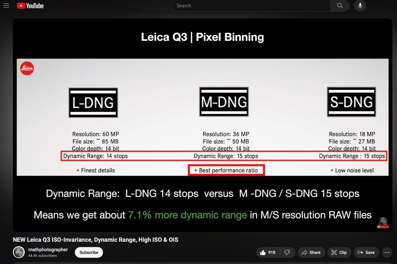

LBJ2 Posted July 14 Share #38 Posted July 14 The most interesting comparison I've seen so far claiming the 36/18MP resolution might have a slight DR edge over the 60MP file is a two year old video by the MathPhotographer in which he tested and compared the Q3's triple resolution. But at the same time, I don't think many on the forums agreed with his results. Personally, I have not found evidence in my own simple/basic comparisons with the M11 triple resolution files, but MathPhotographer certainly carries out an impressive approach to test and compare IMO: Leica Q3 ISO-Invariance, Dynamic Range, High ISO & OIS" width="200" data-embed-src="https://www.youtube-nocookie.com/embed/YH3LT4229ug?feature=oembed"> Welcome, dear visitor! As registered member you'd see an image here… Simply register for free here – We are always happy to welcome new members! Link to post Share on other sites Simply register for free here – We are always happy to welcome new members! ' data-webShareUrl='https://www.l-camera-forum.com/topic/422943-any-downsides-related-to-pixel-binningreduced-mode/?do=findComment&comment=5833562'>More sharing options...

SrMi Posted July 14 Share #40 Posted July 14 55 minutes ago, LBJ2 said: The most interesting comparison I've seen so far claiming the 36/18MP resolution might have a slight DR edge over the 60MP file is a two year old video by the MathPhotographer in which he tested and compared the Q3's triple resolution. But at the same time, I don't think many on the forums agreed with his results. Personally, I have not found evidence in my own simple/basic comparisons with the M11 triple resolution files, but MathPhotographer certainly carries out an impressive approach to test and compare IMO: Welcome, dear visitor! As registered member you'd see an image here… Simply register for free here – We are always happy to welcome new members! He obviously measured DR at the pixel level instead of at the (same-sized) output level. Also, Leica removed any initial claim that lower resolutions increase DR. 1 Link to post Share on other sites More sharing options...
