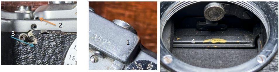

mm0nte Posted October 24, 2024 Share #1 Posted October 24, 2024 (edited) Advertisement (gone after registration) Hello everyone, I’m new to the forum but a long-time enthusiast of Leica cameras and photography in general, writing from Italy. I recently acquired a Leica 250 GG Reporter in the chrome finish from a private seller here in Italy. While most aspects of the camera align with original 250 Reporter models, I obviously have some doubts about its authenticity. The top engraving looks very wonky, it definitely appears to have been re-engraved at some point, and there’s no D.R.P. mark. The camera itself is in poor condition, with missing pieces and patina. It came with a 5cm f/2.5 Ektor lens attached and I do not know much about the history of this specific piece, since the seller was only able to tell me it was inherited from his grandparents. My knowledge in this area is limited, so I’d really appreciate any insights or advice on verifying the authenticity of this piece. I uploaded some pictures on Imgur since the limitation of the forum and I can take more if required. Thanks in advance for your help! Welcome, dear visitor! As registered member you'd see an image here… Simply register for free here – We are always happy to welcome new members! Edited October 24, 2024 by mm0nte Link to post Share on other sites Simply register for free here – We are always happy to welcome new members! ' data-webShareUrl='https://www.l-camera-forum.com/topic/414406-leica-250-gg-reporter-chrome-finish-authenticity/?do=findComment&comment=5672681'>More sharing options...

jerzy Posted October 25, 2024 Share #3 Posted October 25, 2024 you might have seen this http://www.wetzlar-historica-italia.it/250reporter.html There are many details on you camera indicating that this is fake Reporter however with many genuine Leica parts. Most probably a regular IIIa was taken as a basis and Reporter typical parts were manufactured. Reporters from the batch 352xxx were black painted. Here the genuine top cover from IIIa was taken (it was most probably chromed with engraved serial number different than this one), engravings were covered with tin, reengraved and chromed (see 1). Top cover has an indent (2) that was existent on late II/III but not Reporter. Slow speeds dial has been removed, hole (3) in the aluminium body is visible under non-genuine vulcanite. Lightshield (4) is postwar, used for conversions to IIIa syn but not like one from 1940. I am afraid that this is fake Reporter and not the very best. I have seen faked Reporters that were made much much better and only small details (how the gears or hidden film counter mechanism was made) indicated that that was fake. Hektor is genuine, within the batch 161xxx there were nickeled and chromed samples and and some samples from this batch were produced late 30ies/early 40ies and this is in line with engravings on distance scale Welcome, dear visitor! As registered member you'd see an image here… Simply register for free here – We are always happy to welcome new members! 1 1 Link to post Share on other sites Simply register for free here – We are always happy to welcome new members! ' data-webShareUrl='https://www.l-camera-forum.com/topic/414406-leica-250-gg-reporter-chrome-finish-authenticity/?do=findComment&comment=5673312'>More sharing options...
mm0nte Posted October 25, 2024 Author Share #4 Posted October 25, 2024 1 hour ago, jerzy said: you might have seen this http://www.wetzlar-historica-italia.it/250reporter.html There are many details on you camera indicating that this is fake Reporter however with many genuine Leica parts. Most probably a regular IIIa was taken as a basis and Reporter typical parts were manufactured. Reporters from the batch 352xxx were black painted. Here the genuine top cover from IIIa was taken (it was most probably chromed with engraved serial number different than this one), engravings were covered with tin, reengraved and chromed (see 1). Top cover has an indent (2) that was existent on late II/III but not Reporter. Slow speeds dial has been removed, hole (3) in the aluminium body is visible under non-genuine vulcanite. Lightshield (4) is postwar, used for conversions to IIIa syn but not like one from 1940. I am afraid that this is fake Reporter and not the very best. I have seen faked Reporters that were made much much better and only small details (how the gears or hidden film counter mechanism was made) indicated that that was fake. Hektor is genuine, within the batch 161xxx there were nickeled and chromed samples and and some samples from this batch were produced late 30ies/early 40ies and this is in line with engravings on distance scale Welcome, dear visitor! As registered member you'd see an image here… Simply register for free here – We are always happy to welcome new members! Thank you very much, this is what I suspected. It's almost certain that this is a 250 Reporter Frankenstein assembled with some original parts. I didn’t know about the post-war lightshield, and it aligns with the rest. The only thing that still seems strange to me is that the Leica 250 original parts appear very similar to genuine ones, whereas on other fakes I’ve seen, the differences are much more obvious. Am I wrong? Frame counter, knobs, plates appear to be quite close. Link to post Share on other sites More sharing options...
Anbaric Posted October 25, 2024 Share #5 Posted October 25, 2024 2 hours ago, mm0nte said: The only thing that still seems strange to me is that the Leica 250 original parts appear very similar to genuine ones, whereas on other fakes I’ve seen, the differences are much more obvious. Am I wrong? Frame counter, knobs, plates appear to be quite close. It seems like a lot of trouble to go to, only to finish the job with crude engravings, leaving a partially visible slow speed dial socket and a flash sync that could easily have been removed. I wonder if more than one person worked on this, perhaps someone who just wanted to make a Reporter-style camera for practical purposes, and then some chancer who tried inexpertly to make it seem like the real thing, a bit like the story with the Soviet fakes? Link to post Share on other sites More sharing options...
mm0nte Posted October 25, 2024 Author Share #6 Posted October 25, 2024 35 minutes ago, Anbaric said: It seems like a lot of trouble to go to, only to finish the job with crude engravings, leaving a partially visible slow speed dial socket and a flash sync that could easily have been removed. That’s true. I hope someone can provide more information about the actual manufacturing of these copies. Link to post Share on other sites More sharing options...

PG Black nickel Posted October 25, 2024 Share #10 Posted October 25, 2024 I experienced the same thing a few years ago with the same type of chrome reporter 250... But I didn't go through with the purchase because I was very suspicious about the authenticity... It came back several times on sales sites in France. Did I do the right thing? The engravings were better done and maybe it was an original?? The number was 132xxx. It is possible that it was bought by one of us...! Welcome, dear visitor! As registered member you'd see an image here… Simply register for free here – We are always happy to welcome new members! 1 Link to post Share on other sites Simply register for free here – We are always happy to welcome new members! ' data-webShareUrl='https://www.l-camera-forum.com/topic/414406-leica-250-gg-reporter-chrome-finish-authenticity/?do=findComment&comment=5673847'>More sharing options...
mm0nte Posted October 25, 2024 Author Share #11 Posted October 25, 2024 58 minutes ago, luigi bertolotti said: even if... faking the s/n to match a real 250 looks a bit strange, a do it yourself 250 , in that context, should have been made for use, not to pretend/fake originality... 🤔 The @Anbaric theory is growing on me. The engraving could be a third party attempt to fake a good Leica Mod made by some specialist. But at the same time it's so bad that would be almost funny.. no D.R.P., wrong serial, and totally wonky 😂 To be honest I was not expecting this to be an authentic Leica 250, but at the same time I instantly understood it was based on some real stuff and I found it even more fascinating like this. It may not be as valuable as a full legit piece, but it was an absolute steal anyway 1 Link to post Share on other sites More sharing options...
