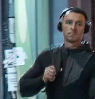

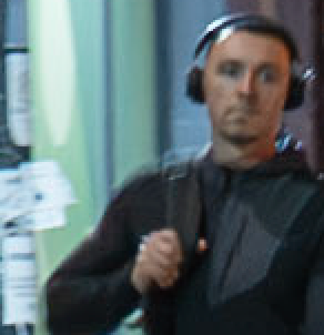

SrMi Posted October 19, 2024 Share #17 Posted October 19, 2024 In previous tests, I found that both DxO and Topaz Photo AI produced worse results than Adobe's Denoise AI. Today, I made a quick comparison between LR's AI Denoise and Topaz Photo AI (applied on exported TIFF): - Adobe has one setting (slider), while Topaz has four settings (three sliders and a button-set). Having more tuning knobs is worse unless necessary. After all, it is called AI and not manual NR. - In default settings, Topaz creates more artifacts. See examples below (200% screen grabs). On the other hand, if you do not use Adobe or DxO as a demosaicing tool in your post-processing chain, I believe Topaz is the only tool that can apply AI NR to an exported TIFF. With Topaz, it is also possible to apply NR to the raw file. I have not looked into it. As an Adobe user, I use Topaz Photo AI mainly for sharpening. Topaz: Welcome, dear visitor! As registered member you'd see an image here… Simply register for free here – We are always happy to welcome new members! Adobe: 1 1 Link to post Share on other sites Simply register for free here – We are always happy to welcome new members! Adobe: ' data-webShareUrl='https://www.l-camera-forum.com/topic/413964-image-recovery-using-topaz-ai-plugin/?do=findComment&comment=5663196'>More sharing options...
Ken Abrahams Posted October 19, 2024 Author Share #18 Posted October 19, 2024 21 minutes ago, SrMi said: In previous tests, I found that both DxO and Topaz Photo AI produced worse results than Adobe's Denoise AI. Today, I made a quick comparison between LR's AI Denoise and Topaz Photo AI (applied on exported TIFF): - Adobe has one setting (slider), while Topaz has four settings (three sliders and a button-set). Having more tuning knobs is worse unless necessary. After all, it is called AI and not manual NR. - In default settings, Topaz creates more artifacts. See examples below (200% screen grabs). On the other hand, if you do not use Adobe or DxO as a demosaicing tool in your post-processing chain, I believe Topaz is the only tool that can apply AI NR to an exported TIFF. With Topaz, it is also possible to apply NR to the raw file. I have not looked into it. As an Adobe user, I use Topaz Photo AI mainly for sharpening. Topaz: Welcome, dear visitor! As registered member you'd see an image here… Simply register for free here – We are always happy to welcome new members! Adobe: Totally go along with what you say and describe here. What I have experienced is that the use of either of the applications seems to be image dependant. Sharpening of images is my primary use of either Adobe Denoise and or Topaz AI. I will always check the preview window at 100% in the Adobe PS or Bridge/ACR and will only use the function if shows a useful difference from the dng. I have tried to use face recovery in Topaz AI and although it shows good recovery with some images, on the whole it is shocking what it can do to slightly blurred images. The sliders in TPZ AI are very useful to bring things back to an acceptable standard especially if I know that I will be adding grain or darkening the image which help disguise these added artefacts. The facial recovery aspects are useable to the degree that those viewing the completed image know nothing about image aberrations and the photographers techniques to remove or hide aberrations in their images. In saying that, sometimes I cannot see any leftover or added artefacts by the app - at all!! I go with the rule that "if I can see the aberrations, they are there and others will see them too", the same goes for halos from masking. I will get great results from Adobe denoise if it shows a good promise in preview window and then follow through with ACR sharpening at the end of working my image too. These two edits used together mostly produce fantastic results. I wont however use this dual applications if I am going to use Silver Efex, only the first denoise step gets applied. I use Topaz AI on the dng file sometimes and others I may only use ACR sharpening in the end stage and defer any pre sharpening/recovery because the Leica lens and photograopher have done their job to produce a very sharp image. Ken 2 Link to post Share on other sites More sharing options...
LocalHero1953 Posted October 19, 2024 Share #19 Posted October 19, 2024 Topaz Photo face recovery has another issue in that the drop off to the surrounding area can be very sharp. A hand held up to the face can be 'recovered' and sharp where near or across the face, but goes blurred very quickly where it extends away, and looks clunky. I'm sure this can be corrected, with care, but, as pointed out above, the term 'AI' ought to mean this extra step is not needed. 1 Link to post Share on other sites More sharing options...
