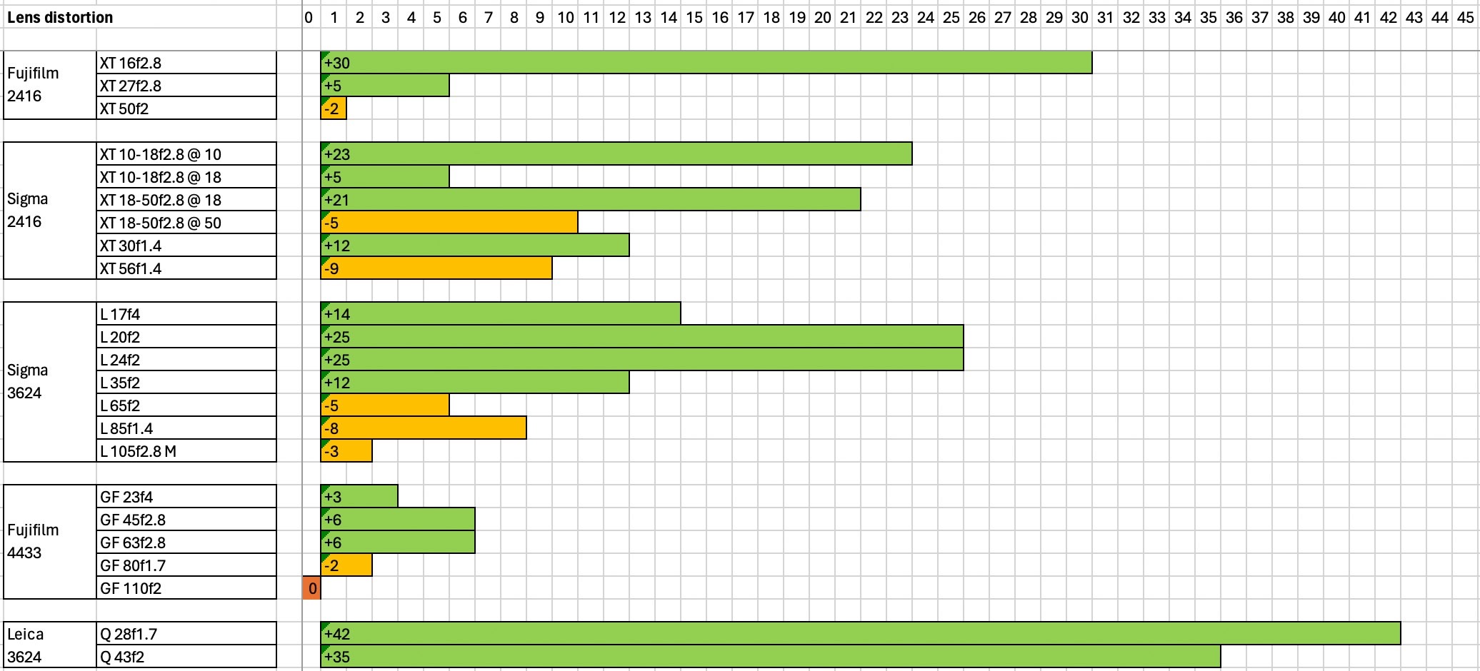

comparing the distortion of some lenses of different formats and brands
(when opening a file w/o distortion correction in ACR and applying the distortion correction there)
Fujifilm GFX lenses have consistently exceptionally low distortion
Sigma 35f2 and 65f2 are maybe most comparable to the Q43 lens: they are not very large, the 35 has quite low distortion, the 65 very low distortion, the 35f2 is optically good, the 65f2 is great
Q lenses distortions ... hmm
