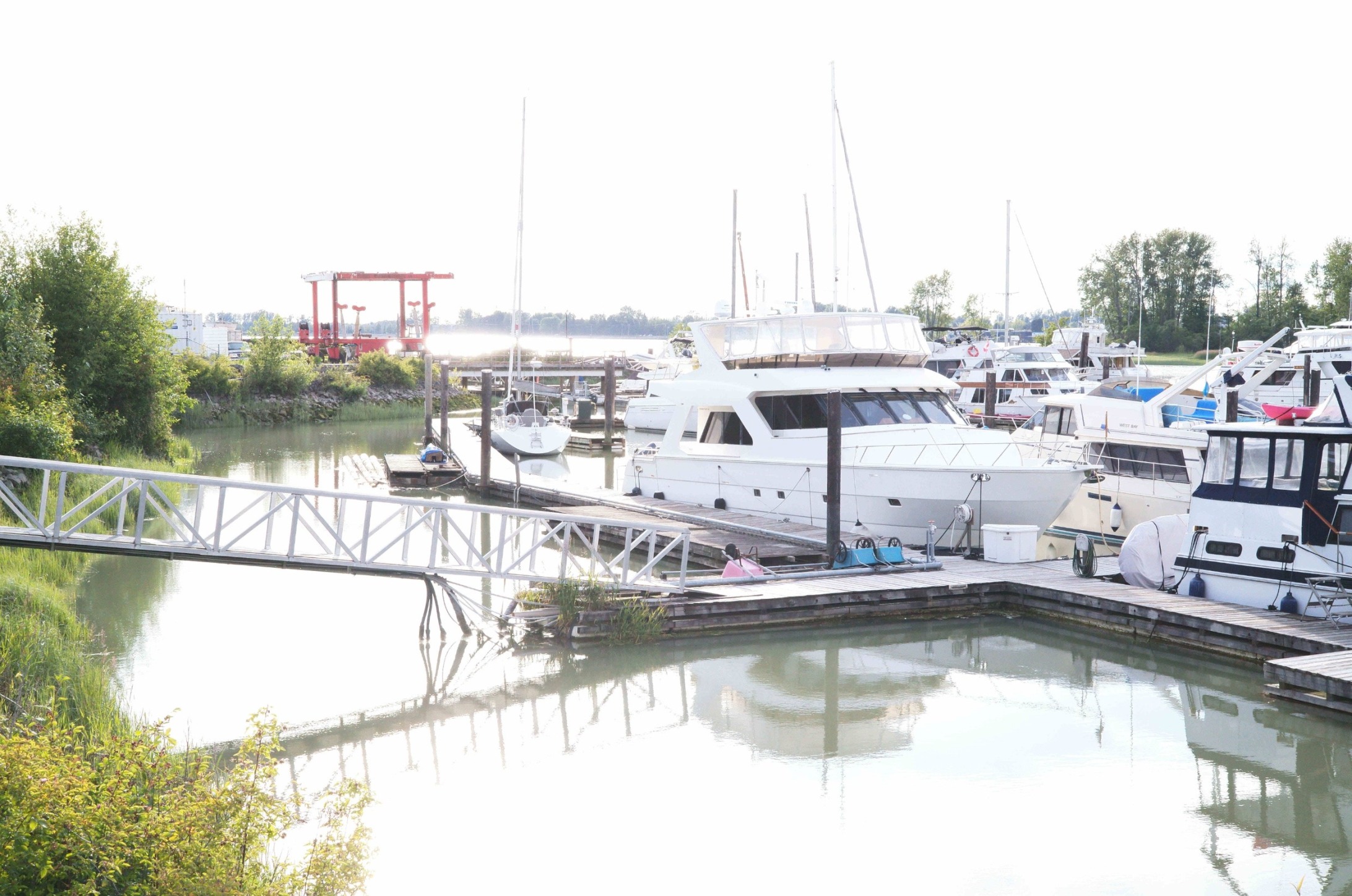

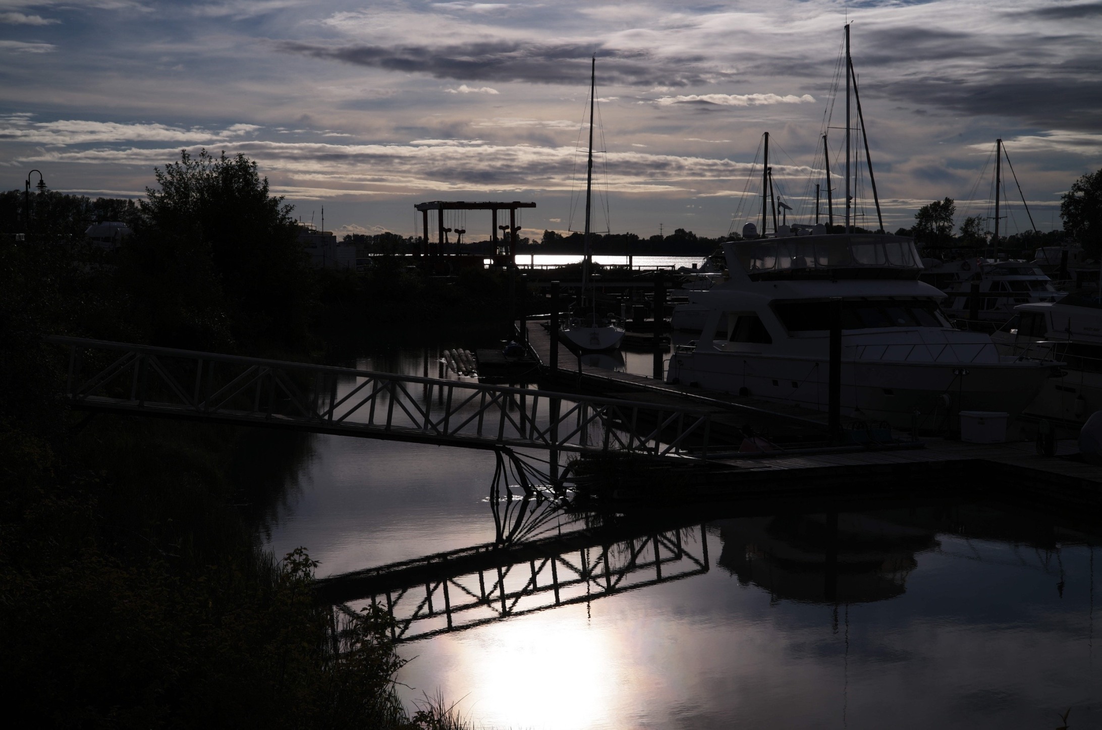

PeterKelly Posted June 17, 2024 Author Share #20 Posted June 17, 2024 2 hours ago, lct said: Would be interesting to see your photos as f/8 1/500s should be very dark at night at 64 iso i guess. I deleted the original overexposed one but here are the others - settings were f13 1/360 auto ISO with minus 2/3 exp comp. The underexposed one is at ISO64 and the overexposed one is where the ISO jumped to 2000. I was shooting into the setting sun and trying to underexpose to hold detail in the sky and then experiment in post on recovering the shadows. The M11 is new to me and I am experimenting to try and learn it's exposure bias. Can only upload one at a time - here is the underexposed one Welcome, dear visitor! As registered member you'd see an image here… Simply register for free here – We are always happy to welcome new members! 1 Link to post Share on other sites Simply register for free here – We are always happy to welcome new members! ' data-webShareUrl='https://www.l-camera-forum.com/topic/396048-m11-intermittent-over-exposure/?do=findComment&comment=5363152'>More sharing options...
