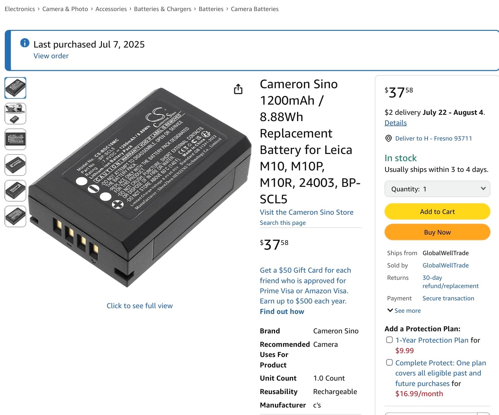

lekitr Posted August 13 Share #303 Posted August 13 1 hour ago, 84bravo said: I have one of the aftermarket M10 batteries and so far it works exactly like the OEM battery for the few full cycles I've run it through. I charged the battery on a Leica charger and it shows 100% and lasts about the same as the original. It also seems to accurately show the charge level as I use it. I typically recharge the battery when I'm around 20%. After a week of no use the batt dropped to 95%. Hi, which one is it, fotagogo or Cameron sino. Or maybe another one. Thk 1 Link to post Share on other sites More sharing options...
84bravo Posted August 21 Share #304 Posted August 21 On 8/12/2025 at 8:33 PM, lekitr said: Hi, which one is it, fotagogo or Cameron sino. Or maybe another one. Thk Cameron Sino, less than $40 US from Amazon. 2 Link to post Share on other sites More sharing options...

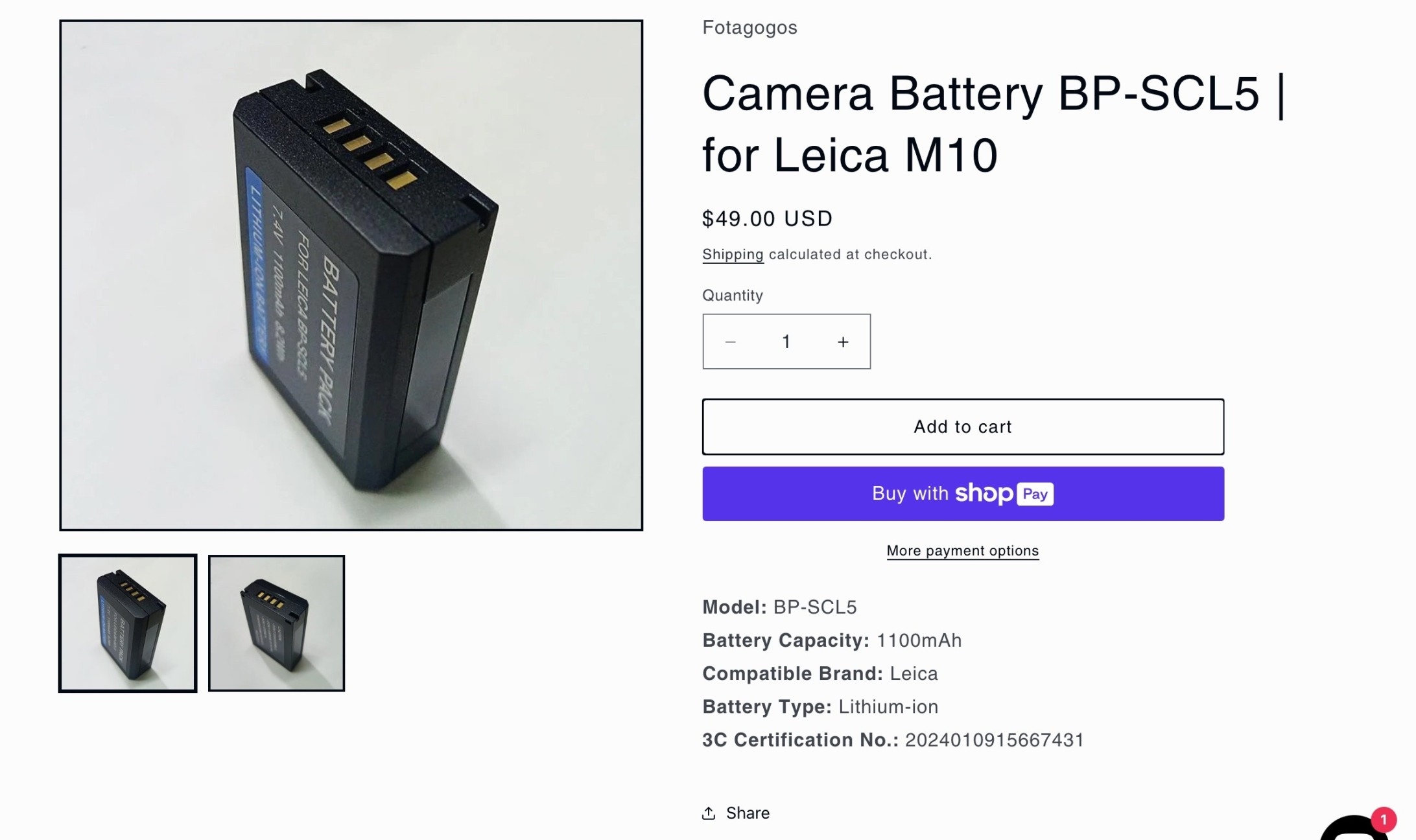

TomB_tx Posted August 24 Share #307 Posted August 24 Advertisement (gone after registration) The Cameron Sino battery seems to be performing properly after a few change cycles showing remaining charge usefully in camera, but the Fotagogo still shows 100% in camera until it suddenly dies and the camera just says change battery. So I'm giving up on Fotogogo. 1 Link to post Share on other sites More sharing options...
jakontil Posted September 14 Share #308 Posted September 14 On 8/25/2025 at 12:25 AM, TomB_tx said: The Cameron Sino battery seems to be performing properly after a few change cycles showing remaining charge usefully in camera, but the Fotagogo still shows 100% in camera until it suddenly dies and the camera just says change battery. So I'm giving up on Fotogogo. The fotogogo seems fit my needs though, only if i still have my m10r.. i have this anxiety seeing how many percentage left on a battery.. solution with this just to carry spare one when it died suddenly, provided it lasts as good as the OEM more or less Link to post Share on other sites More sharing options...
