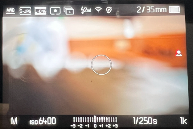

Jon Warwick Posted February 9, 2024 Share #6 Posted February 9, 2024 How big is the spot, ie, presumably bigger than a 1% measure on dedicated handheld meters? And with the M11 in spot meter mode, is there a circle in live view that shows what area is precisely being spot metered? Link to post Share on other sites More sharing options...
lct Posted February 9, 2024 Share #7 Posted February 9, 2024 Advertisement (gone after registration) 1 hour ago, Jon Warwick said: How big is the spot, ie, presumably bigger than a 1% measure on dedicated handheld meters? And with the M11 in spot meter mode, is there a circle in live view that shows what area is precisely being spot metered? There is indeed a circle in LV mode. It will give you an idea on the size of the spot but my only infos about this size come from earlier cameras sorry. 1 Link to post Share on other sites More sharing options...
DrM Posted February 9, 2024 Share #8 Posted February 9, 2024 (edited) The percentage I don't know, but I can imagine it just uses the pixels in the circle. If this assumption holds, measure the size and you can calculate the percentage and the depending on the lens used the angle. Edited February 9, 2024 by DrM 1 Link to post Share on other sites More sharing options...
DrM Posted February 9, 2024 Share #9 Posted February 9, 2024 (edited) Based on a quick and dirty screenshot with the spot on it is about 1,3% of the pixels. Welcome, dear visitor! As registered member you'd see an image here… Simply register for free here – We are always happy to welcome new members! Edited February 9, 2024 by DrM 1 2 Link to post Share on other sites Simply register for free here – We are always happy to welcome new members! ' data-webShareUrl='https://www.l-camera-forum.com/topic/388388-m11-spot-metering/?do=findComment&comment=5029618'>More sharing options...

M11 for me Posted February 9, 2024 Share #11 Posted February 9, 2024 (edited) vor 4 Stunden schrieb DrM: Based on a quick and dirty screenshot with the spot on it is about 1,3% of the pixels. Welcome, dear visitor! As registered member you'd see an image here… Simply register for free here – We are always happy to welcome new members! Plus the spot can be moved around . . . Edited February 9, 2024 by M11 for me 1 Link to post Share on other sites More sharing options...
