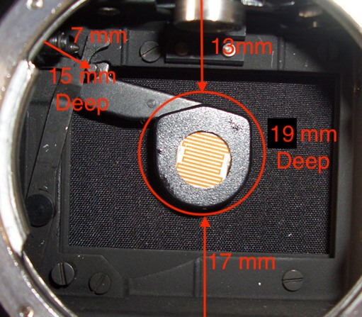

dpitt Posted August 24, 2023 Share #9 Posted August 24, 2023 16 hours ago, blackdot said: Ok, the rear cell of the Biogon is about 13mm. The Super Elmar is about 12, and 35 asph cron is about 12.5. When you say 12mm "on the side", do you mean out of the way of the rear cell part? I want to say that the nearest mechanism inside the mount is on the side of the mount and below. If the protruding part is small enough in diameter it will miss it. Then the 'highest' obstacle is the light meter cel in the middle, and that is around 15mm deep. I can try a more accurate measurement when I get home tomorrow, but it will be dangerous to use any lens entering more than 14 mm in the center. If the protective barrel of the rear element is wide enough to touch the higher part of the mechanism on the side of the mount (at about 12 mm deep) then it is harder to avoid damage. When mounting or dismounting, the lens might be slightly tilted, so the sides are probably the hardest to avoid if the protective barrel is only millimeters from touching when mounted. Link to post Share on other sites More sharing options...
dpitt Posted August 26, 2023 Share #10 Posted August 26, 2023 Sorry for the delay. I promised some more accurate measurements. See the photo below. The circle around the light meter cell is around 16mm in diameter. It is quite deep, at 21 mm and asymmetrically placed. (see measurements from the inside of the mount). The main issue is the pin on the mechanism. It is only 15mm deep. I leave it up to you how close you dare to go. I think a few mm is a minimum for normal use. If you mount the lens once and never change it in the field, you might risk going closer. Welcome, dear visitor! As registered member you'd see an image here… Simply register for free here – We are always happy to welcome new members! 1 Link to post Share on other sites Simply register for free here – We are always happy to welcome new members! ' data-webShareUrl='https://www.l-camera-forum.com/topic/381195-leica-cl-lens-compatibility/?do=findComment&comment=4843814'>More sharing options...
blackdot Posted August 26, 2023 Author Share #11 Posted August 26, 2023 8 hours ago, dpitt said: Sorry for the delay. I promised some more accurate measurements. See the photo below. The circle around the light meter cell is around 16mm in diameter. It is quite deep, at 21 mm and asymmetrically placed. (see measurements from the inside of the mount). The main issue is the pin on the mechanism. It is only 15mm deep. I leave it up to you how close you dare to go. I think a few mm is a minimum for normal use. If you mount the lens once and never change it in the field, you might risk going closer. Welcome, dear visitor! As registered member you'd see an image here… Simply register for free here – We are always happy to welcome new members! Thank you so much for the detailed response! Looks like my lenses should all be fine. Link to post Share on other sites More sharing options...
dpitt Posted August 27, 2023 Share #12 Posted August 27, 2023 (edited) Oh. I am so sorry @blackdot . I now realize I made a crucial mistake. I used a small wooden piece to support my measuring tool in the middle of the hole. After subtracting its thickness, I see now that the cell is only a bit more than 19mm deep. I hope it makes no difference for you. This is the corrected picture. Welcome, dear visitor! As registered member you'd see an image here… Simply register for free here – We are always happy to welcome new members! Edited August 27, 2023 by dpitt 1 Link to post Share on other sites Simply register for free here – We are always happy to welcome new members! ' data-webShareUrl='https://www.l-camera-forum.com/topic/381195-leica-cl-lens-compatibility/?do=findComment&comment=4844701'>More sharing options...
blackdot Posted August 28, 2023 Author Share #13 Posted August 28, 2023 13 hours ago, dpitt said: Oh. I am so sorry @blackdot . I now realize I made a crucial mistake. I used a small wooden piece to support my measuring tool in the middle of the hole. After subtracting its thickness, I see now that the cell is only a bit more than 19mm deep. I hope it makes no difference for you. This is the corrected picture. Welcome, dear visitor! As registered member you'd see an image here… Simply register for free here – We are always happy to welcome new members! Thanks for the update. 19mm is still plenty of space for my Biogon. Link to post Share on other sites More sharing options...
