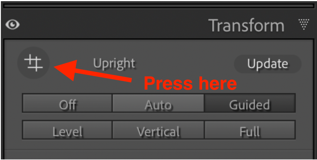

SrMi Posted July 4, 2023 Share #11 Posted July 4, 2023 (edited) 1 hour ago, sparkone said: I feel a bit stupid because i followed your instructions, on the import I see the picture corrected and when the loading is finished and I go into the develop section the un-corrected picture is there. Are you using Lightroom Classic, and what version? Have you set Preferences as shown below? (must be "Camera Settings"). Have you tried manually applying LPC by pressing the Guided button (see below)? Welcome, dear visitor! As registered member you'd see an image here… Simply register for free here – We are always happy to welcome new members! Edited July 4, 2023 by SrMi Link to post Share on other sites Simply register for free here – We are always happy to welcome new members! ' data-webShareUrl='https://www.l-camera-forum.com/topic/378680-leica-q3-how-to-activate-perspective-control/?do=findComment&comment=4807474'>More sharing options...

SrMi Posted July 4, 2023 Share #13 Posted July 4, 2023 (edited) 17 minutes ago, M11 for me said: Welcome, dear visitor! As registered member you'd see an image here… Simply register for free here – We are always happy to welcome new members! Why? You need to press that only if you want to modify LPC. Edited July 4, 2023 by SrMi Link to post Share on other sites More sharing options...

M11 for me Posted July 5, 2023 Share #15 Posted July 5, 2023 vor 17 Stunden schrieb SrMi: Why? You need to press that only if you want to modify LPC. In my LR Classic implementation on Mac I have to press there to activate the PC. Then the picture that is primarily redered without PC jumps to strait falling lines (I can of corse change) as taken by my camera. Link to post Share on other sites More sharing options...
