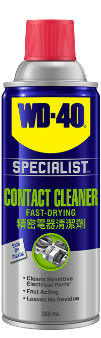

Robert Blanko Posted April 17, 2023 Share #8 Posted April 17, 2023 vor 13 Stunden schrieb Somchai: Please. Listen to my advice. DO NOT put anything on your camera buttons or clean any dials with anything other than Contact Cleaner. Obviously make sure it doesn’t go anywhere except in your shutter button. I used it for my Fujis when the buttons were sticky. On my Leica I used it to remove the sticker from the bottom plate because it’s the only thing I trust around any electronics This is specifically designed for electronics and it’s safe even on rubber. It cleans and lubricates. You can spray down an whole motherboard with it. Again do not use anything other than contact cleaner. find it at your local hardware store Anyway. Once you have this you can spray it down the shutter button with confidence. Again don’t let any sprays get on your lenses or sensor. I would keep this spray for deep cleaning of the dials also. Doesn’t matter the camera. https://www.amazon.com/WD-40-Specialist-Electrical-Contact-Cleaner/dp/B00AF0OFVU#immersive-view_1681672020951 Welcome, dear visitor! As registered member you'd see an image here… Simply register for free here – We are always happy to welcome new members! Link to post Share on other sites More sharing options...

Robert Blanko Posted April 17, 2023 Share #12 Posted April 17, 2023 vor 1 Stunde schrieb Robert Blanko: 🤔 actually, I thought my posting was cancelled before publishing. Well, one thing I would consider: WD-40 is a penetrating oil which creeps everywhere. I would not use this on a camera. Link to post Share on other sites More sharing options...
charlesphoto99 Posted April 17, 2023 Share #13 Posted April 17, 2023 2 hours ago, Robert Blanko said: 🤔 actually, I thought my posting was cancelled before publishing. Well, one thing I would consider: WD-40 is a penetrating oil which creeps everywhere. I would not use this on a camera. He’s suggesting ‘contact cleaner’ made by WD-40, not the lubricant made by WD-40, which should go nowhere other than a bike chain. 1 Link to post Share on other sites More sharing options...
Robert Blanko Posted April 17, 2023 Share #14 Posted April 17, 2023 vor 47 Minuten schrieb charlesphoto99: He’s suggesting ‘contact cleaner’ made by WD-40, not the lubricant made by WD-40, which should go nowhere other than a bike chain. Ah, got it! 😂 Link to post Share on other sites More sharing options...
Robert Blanko Posted April 17, 2023 Share #15 Posted April 17, 2023 vor 29 Minuten schrieb Somchai: Do not ever use WD-40 the oil on electronics. Certainly not on your camera. I am talking about Contact Cleaner, and I can vouch for the one made by WD-40. You can spray down a paper towel with it and it’ll dry within seconds. It’s really good and I always keep a bottle at home. Good point. So far, I always considered "WD-40" as synonym for their special lubricant, but it's actually the brand of the company https://en.wikipedia.org/wiki/WD-40 (allegedly) named after the abbreviation from the term "Water Displacement, 40th formula", suggesting it was the result of the 40th attempt to create the product. Link to post Share on other sites More sharing options...
Anbaric Posted April 17, 2023 Share #16 Posted April 17, 2023 (edited) 7 hours ago, charlesphoto99 said: He’s suggesting ‘contact cleaner’ made by WD-40, not the lubricant made by WD-40, which should go nowhere other than a bike chain. On bike forums, suggesting you should put WD-40 (the original stuff) on your chain is like saying you should always use a UV filter on your lenses here - controversial! Edited April 17, 2023 by Anbaric 1 Link to post Share on other sites More sharing options...
Bikie John Posted April 18, 2023 Share #17 Posted April 18, 2023 13 hours ago, Robert Blanko said: Good point. So far, I always considered "WD-40" as synonym for their special lubricant, but it's actually the brand of the company https://en.wikipedia.org/wiki/WD-40 (allegedly) named after the abbreviation from the term "Water Displacement, 40th formula", suggesting it was the result of the 40th attempt to create the product. When IBM produced their line of big general-purpose mainframe computers in the mid-1960s, they called it "System 360" because it was an "all round system" - therefore "it covered all 360 degrees to cover the entire circle of possible uses". Allegedly, at a very prestigious press launch a Big Cheese from IBM was sat with a young journalist and asked "Do you know why we call it System 360?". To which the journo commendably replied "I thought it was because the first 359 didn't work". Off-topic, sorry John 1 Link to post Share on other sites More sharing options...
