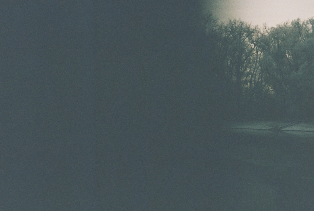

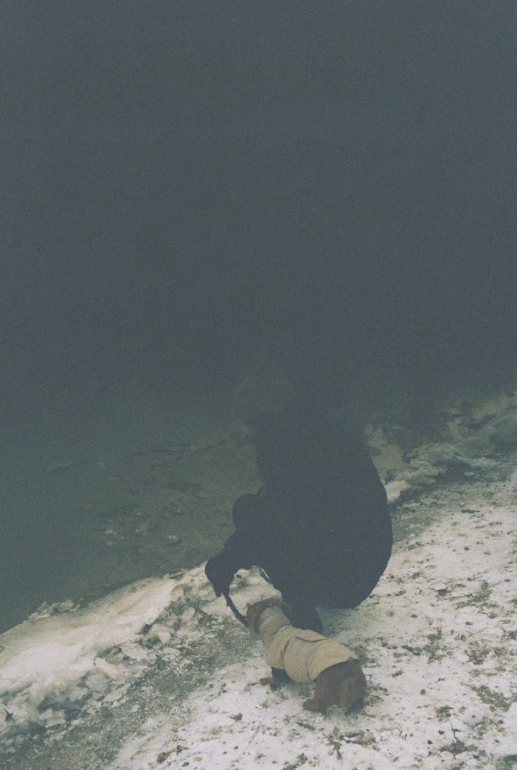

williamj Posted January 5, 2023 Share #27 Posted January 5, 2023 Advertisement (gone after registration) 10 hours ago, Jewl said: Hi all, just received the scans of my first 3 rolls shot with the new M6 released in November. I am not sure whether this is normal/should be tolerated but I have out of 2 rolls, ca. 6 photos that have big shadows (2/3 of the picture) - seems the shutter has not properly opened? - The pictures before and after those seem to be properly exposed. Two examples: Welcome, dear visitor! As registered member you'd see an image here… Simply register for free here – We are always happy to welcome new members! What do you think? Is this normal when shooting film? (I am quite new, at least to the M6) Thanks, Jewl This looks like a shutter problem for sure, which should be simple to confirm. It looks same but different to what happens when you use a flash at exposures faster than 1/50 on a Leica, except the edges are blurry. What some have been saying, in simple language, is that the second curtain is catching up with the first curtain in your focal plane shutter. It could be lubrication issues of the shutter, if the lubrication dries or stiffens, working the shutter can improve it. At fast exposures you won't be able to observe a change in window width but you may be able to observe this at slower exposures. Importantly, at speeds slower than 1/50 the entire frame will be visible for a short time. If the entire frame is not visible at say 1/15 of a second then you've got a problem. It also means that the shutter appears to work properly at some but not all speeds. So do what Huss says, remove film from the camera, remove the lens, open the back flap, have a light source (e.g. window) behind, and look through. Here's the difference. Film this in slow motion with your iPhone. At speeds faster than 1/50 you'll see a slit move across, it needs to be the same width all the way, it should not disappear half way across. At speeds slower than 1/50 you have to see the entire frame illuminated. I've used this method to determine that the self timer of my M3 doesn't work, it sounds like it's working, but it's not. The rest of the shutter is fine. It was so obvious I didn't need slow motion to detect it. Why is this worse than scratched negatives? They don't pull film through the film gate during final testing but they for sure calibrate your shutter before it leaves the factory, they put it up to a machine to determine that it is up to specification. That's why half your respondents are saying it can't be the shutter you must have put something in front of the lens. Leica Ms have been used in the ice and snow, there's plenty of evidence of that, so it's not that it was a chilly day. But the shutter, although new, could have been sitting around for a while and the lubrication might have stiffened. Or any one of tens of possibilities. Cheers. Link to post Share on other sites More sharing options...
andybarton Posted January 5, 2023 Share #28 Posted January 5, 2023 35 minutes ago, Mooshoepork said: It’s obviously 100% a shutter issue. It's difficult to tell with the dark photographs, which is why I suggested sharing the ones taken indoors. The shadow doesn't necessarily look horizontal/vertical in the images shared, from what I can see. If you're so sure that it is, then that's fine. Eliminate all the possibilities in order, starting with the simplest, such as a glove or finger across the lens. before jumping to a conclusion that would require a camera to be sent back for repair / exchange. Edit: I see that the camera is back with Leica to have a loose mount dealt with, so if they already know about this issue, then they can retest the shutter and fix that too, if it is indeed the problem. 1 Link to post Share on other sites More sharing options...

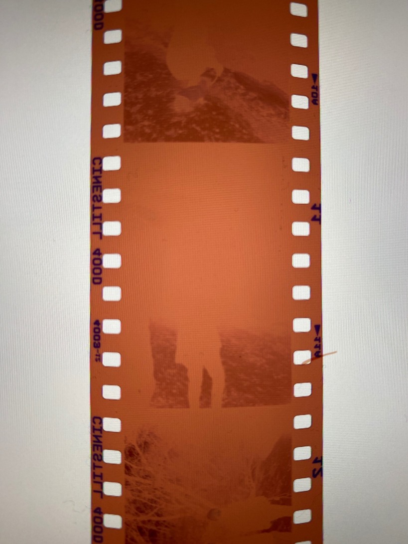

Jewl Posted January 12, 2023 Author Share #38 Posted January 12, 2023 Alrighty, just received the negatives back from the lab. It seems, this was not a scanning issue as the negatives show the same shadows as the scans. Will send those to Leica as well... Please see below: Welcome, dear visitor! As registered member you'd see an image here… Simply register for free here – We are always happy to welcome new members! 2 Link to post Share on other sites Simply register for free here – We are always happy to welcome new members! ' data-webShareUrl='https://www.l-camera-forum.com/topic/359299-m6-2022-black-shadows-on-some-photos-per-roll/?do=findComment&comment=4638677'>More sharing options...
Huss Posted January 12, 2023 Share #39 Posted January 12, 2023 Yeah, that is a shutter issue. Heavy sigh. Link to post Share on other sites More sharing options...
