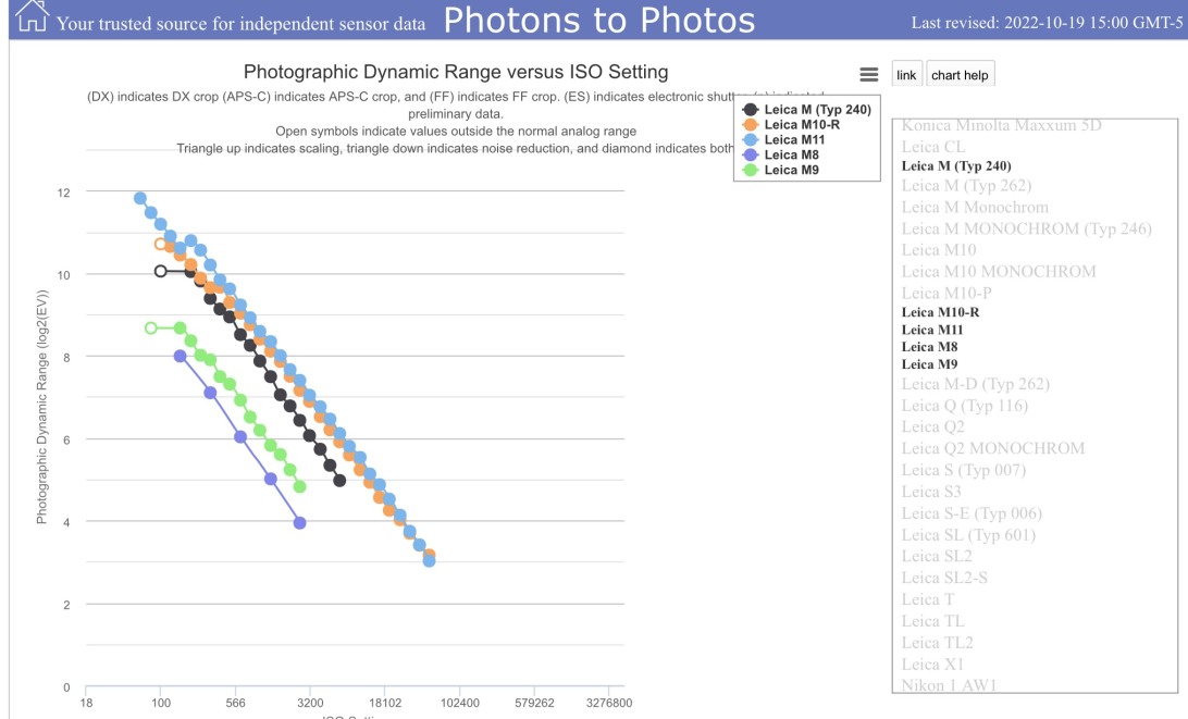

a.noctilux Posted November 4, 2022 Share #2 Posted November 4, 2022 As M10 user since it's availability, I don't need more pixels and happy with the M10, for me good enough. You may find some sensor related data in this website https://www.photonstophotos.net/Charts/PDR.htm#Leica M10,Leica M10-R Sorry not providing "real" comparisons, maybe somebody will do. Link to post Share on other sites More sharing options...

Adam Bonn Posted November 4, 2022 Share #12 Posted November 4, 2022 https://photonstophotos.net/Charts/PDR.htm#Leica M10,Leica M10-R Welcome, dear visitor! As registered member you'd see an image here… Simply register for free here – We are always happy to welcome new members! according to P2P it’s no where near a stop of DR But that’s the point, DR and exposure latitude aren’t the same thing. Interestingly… in DxO’s M10 iso test shows that what Leica calls 200 they rate as basically 100 anyway. Annoyingly they never tested the 10R Link to post Share on other sites Simply register for free here – We are always happy to welcome new members! according to P2P it’s no where near a stop of DR But that’s the point, DR and exposure latitude aren’t the same thing. Interestingly… in DxO’s M10 iso test shows that what Leica calls 200 they rate as basically 100 anyway. Annoyingly they never tested the 10R ' data-webShareUrl='https://www.l-camera-forum.com/topic/344692-m10-vs-m10-r-dynamic-range/?do=findComment&comment=4555298'>More sharing options...

Chimichurri Posted November 4, 2022 Share #19 Posted November 4, 2022 (edited) 2 hours ago, thrid said: I was mainly looking for some measurement and user feedback on the M10 vs 10R sensor. Check the screenshot from PtoP website I posted. The readings don’t show much difference between the 2 if you just want to see the raw numbers. But my experience is like the Reddotforum article they posted for you. You see something you think, oh that’s gone. You open the RAW and you can recover noticeably more than on the M10. Honestly I’m at the point I don’t even worry about it much because I know I’ll be able to recover in post if it’s too hard to expose. Edited November 4, 2022 by Chimichurri Link to post Share on other sites More sharing options...
