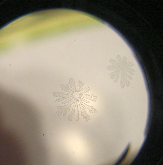

jerzy Posted October 10, 2022 Share #9  Posted October 10, 2022 separation in Elmar 5cm happens rare but is possible as well. This is how the rear group in my Elmar was. Warming up the rear group to 90C and pressing both lenses together helped to distribute canada balsam between the lenses. But you need to disassembly the lens and it does not always work. Alternative is to remove cemented group from the mount, separate completly, clean and re- cement. Pretty complex task. Welcome, dear visitor! As registered member you'd see an image here… Simply register for free here – We are always happy to welcome new members! 1 1 Link to post Share on other sites Simply register for free here – We are always happy to welcome new members! ' data-webShareUrl='https://www.l-camera-forum.com/topic/339897-strange-leitz-elmar-5cm-35-from-a-leica-ii-converted-to-iiia/?do=findComment&comment=4529485'>More sharing options...
nitroplait Posted October 10, 2022 Share #10  Posted October 10, 2022 12 minutes ago, jerzy said: This is how the rear group in my Elmar was. Welcome, dear visitor! As registered member you'd see an image here… Simply register for free here – We are always happy to welcome new members! Very organic looking - quite fascinating. I understand why some may mistake it for fungus. Link to post Share on other sites More sharing options...
wizard Posted October 10, 2022 Share #11 Â Posted October 10, 2022 vor 1 Stunde schrieb jerzy: This is how the rear group in my Elmar was. Jerzy, are you sure that this was separation? I have seen separation in lenses several times, and it never looked like this, not even close. This looks like some sort of fungus to me. Of course, if you heat up the lens group and then press the lens elements together, you will re-shift the still existing Canada balsam, which has softened due to the elevated temperature, into those regions were fungus has 'eaten' the balsam. But that does not mean those structures have been caused by normal lens separation. Lens separation is a mechanical process, and it will in my view not be able to form such organic looking structures. Â vor 1 Stunde schrieb nitroplait: Very organic looking - quite fascinating. I understand why some may mistake it for fungus. As explained above, I would be very, very surprised if it were not fungus. 1 Link to post Share on other sites More sharing options...
jerzy Posted October 10, 2022 Share #12  Posted October 10, 2022 (edited) vor 4 Stunden schrieb wizard: Jerzy, are you sure that this was separation? yes, I am pretty sure. I do not know what was a reason, but I believe that canada balsam dried out on some spots therefore such unusual pattern. Here is another example of separation, this time Summar - notice round spots, again, canada balsam dried. On the right photo lens group is separated Welcome, dear visitor! As registered member you'd see an image here… Simply register for free here – We are always happy to welcome new members! from my experience fungus may developes another pattern and what I observed it developes on the surfaces that have air contact. Here is example of M3 rangefiner, fungus was on the prism, behind the first lens (there is approx 2mm air distance between prism and the front lens  Edited October 10, 2022 by jerzy 2 Link to post Share on other sites Simply register for free here – We are always happy to welcome new members! from my experience fungus may developes another pattern and what I observed it developes on the surfaces that have air contact. Here is example of M3 rangefiner, fungus was on the prism, behind the first lens (there is approx 2mm air distance between prism and the front lens  ' data-webShareUrl='https://www.l-camera-forum.com/topic/339897-strange-leitz-elmar-5cm-35-from-a-leica-ii-converted-to-iiia/?do=findComment&comment=4529781'>More sharing options...
zeitz Posted October 10, 2022 Share #13 Â Posted October 10, 2022 4 hours ago, wizard said: I would be very, very surprised if it were not fungus. I have never seen fungus develop between the elements of a cemented pair. Â Particularly since the pattern is in the center and does not start along an edge of the interface. Â But I have been surprised before, especially how fungus can get to the most difficult to reach surfaces and leave other surfaces clean. Link to post Share on other sites More sharing options...
wizard Posted October 11, 2022 Share #14  Posted October 11, 2022 vor 12 Stunden schrieb zeitz: I have never seen fungus develop between the elements of a cemented pair. Well, Canada balsam is an organic substance to start with. Perhaps a tiny amount of fungus spore was part of the substance when it was processed at the time, and just needed the right environmental conditions to grow. Link to post Share on other sites More sharing options...
