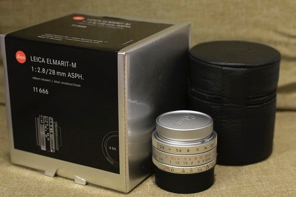

lct Posted August 24, 2022 Share #3  Posted August 24, 2022 (edited) 18 minutes ago, George Stoichev said: I have read that there is some problem with 3rd version, is this true You mean Elmarit-M 28/2.8 asph v1 perhaps? (pic). My favorite compact 28 ever. So compact that i'm not tempted by the current version. Same reason why i'm not tempted by the Biogon either. No idea what problems it may have, never seen any in 15+ years. Highly recommended. Welcome, dear visitor! As registered member you'd see an image here… Simply register for free here – We are always happy to welcome new members! Edited August 24, 2022 by lct 2 Link to post Share on other sites Simply register for free here – We are always happy to welcome new members! ' data-webShareUrl='https://www.l-camera-forum.com/topic/335903-elmarit-m-28mm/?do=findComment&comment=4496253'>More sharing options...

lct Posted August 24, 2022 Share #8  Posted August 24, 2022 (edited) 29 minutes ago, George Stoichev said: For which version you are talking about? That of the photo above (11606). Existed also in silver (11666 below). Welcome, dear visitor! As registered member you'd see an image here… Simply register for free here – We are always happy to welcome new members! Edited August 24, 2022 by lct Link to post Share on other sites Simply register for free here – We are always happy to welcome new members! ' data-webShareUrl='https://www.l-camera-forum.com/topic/335903-elmarit-m-28mm/?do=findComment&comment=4496272'>More sharing options...
