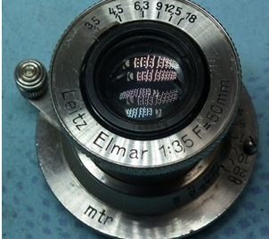

Rannedge Posted June 26, 2022 Share #1  Posted June 26, 2022 Advertisement (gone after registration) Advice please? Total newby. I have acquired a Model II Leica. Ser No.93276 which by my research should mean 1932  Lens is Leitz Elmar 1:3,5 F=50mm. Ser No. 144321. I am plagued by doubts about its authenticity, mainly because it is pretty much in better condition than most I have seen on the auction site starting with E. I have looked at all the obvious info online which illustrates copies and fakes. It passes all the tests. It belonged to a relative of mine who was a keen photographer and is in an authentic Leica case which is also in fine condition. The one area that concerns me is the area around the tripod thread. There are three fastenings around it. Mine are screws, but I’ve been told that they should be rivets. Studying many photos, some show screws, others rivets. All other characteristics are as they should be, sewn shutter, wheel type cam for rangefinder, it’s just this screw question that’s bugging me.. I stress that this is not a request for valuation, merely advice on authenticity. Thank you.  Welcome, dear visitor! As registered member you'd see an image here… Simply register for free here – We are always happy to welcome new members! Link to post Share on other sites Simply register for free here – We are always happy to welcome new members! ' data-webShareUrl='https://www.l-camera-forum.com/topic/333905-recently-acquired-mod-ii-leica/?do=findComment&comment=4460065'>More sharing options...

jerzy Posted June 26, 2022 Share #12  Posted June 26, 2022 Beautifull camera! Did you remove 1m pin on the lens flange on purpose? Lens shall be removed with the flange,  pin has to stay where it was. In order to screw in the lens the distance mark shall be approx at 1,7m. Link to post Share on other sites More sharing options...
jerzy Posted June 26, 2022 Share #13  Posted June 26, 2022 Sorry, I meant the infinity pin Link to post Share on other sites More sharing options...
Rannedge Posted June 26, 2022 Author Share #14  Posted June 26, 2022 (edited) If it’s the pin I think you mean, yes I removed it in order to remove the lens. You will see it on earlier pictures? The rangefinder is accurate at infinity. Edited June 26, 2022 by Rannedge Link to post Share on other sites More sharing options...
jaapv Posted June 26, 2022 Share #15 Â Posted June 26, 2022 I think that the lens has a bit of haze. I would have it cleaned. Well worth it. Link to post Share on other sites More sharing options...
jerzy Posted June 26, 2022 Share #16  Posted June 26, 2022 vor 8 Minuten schrieb Rannedge: yes I removed it in order to remove the lens Welcome, dear visitor! As registered member you'd see an image here… Simply register for free here – We are always happy to welcome new members! you shall not remove this pin in order top unscrew the lens, it unscrews like this, with the pin in Link to post Share on other sites Simply register for free here – We are always happy to welcome new members! you shall not remove this pin in order top unscrew the lens, it unscrews like this, with the pin in ' data-webShareUrl='https://www.l-camera-forum.com/topic/333905-recently-acquired-mod-ii-leica/?do=findComment&comment=4460207'>More sharing options...
