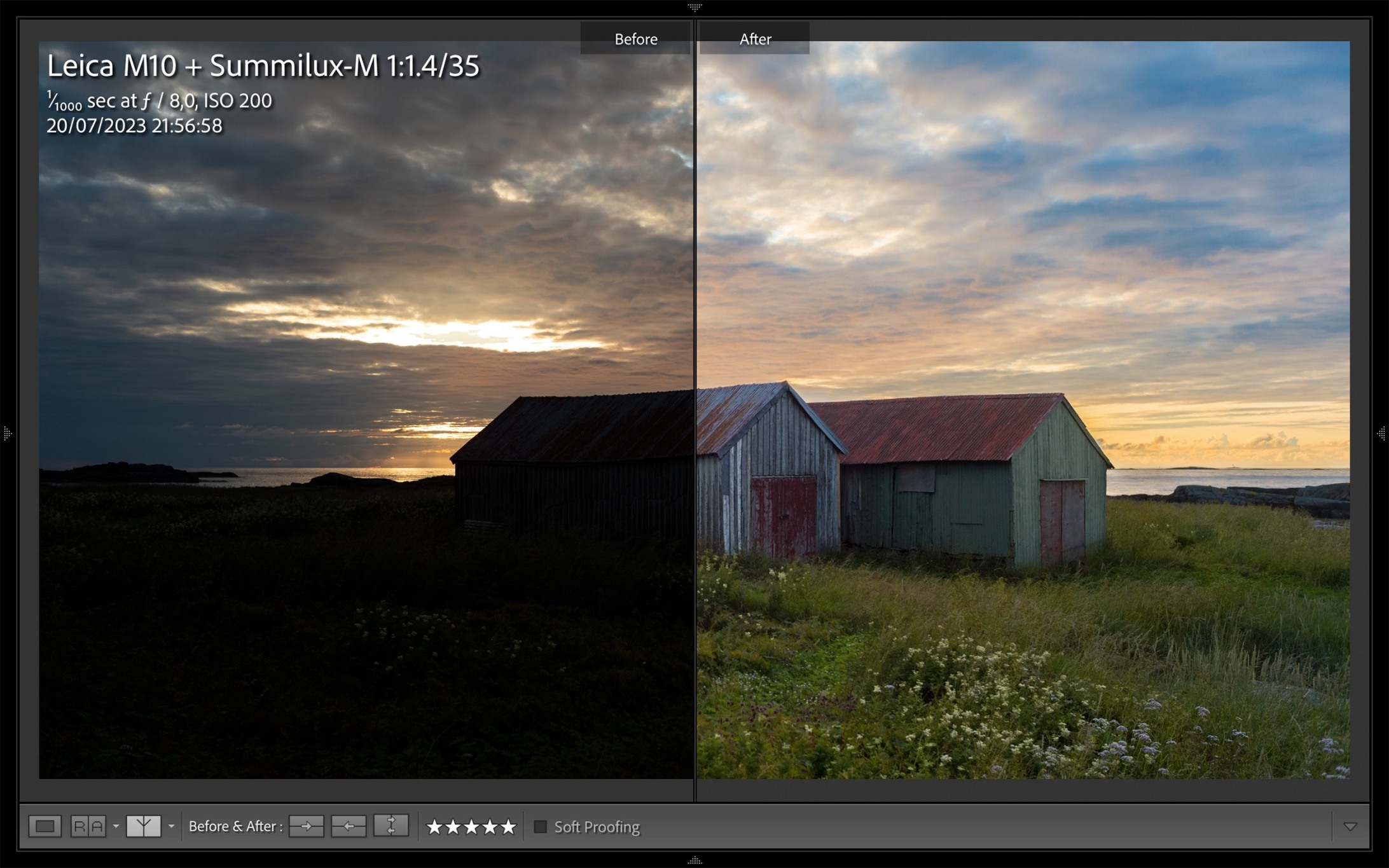

adan Posted June 22, 2022 Share #15 Posted June 22, 2022 (edited) Expose for the highlights - expose for the highlights - expose for the highlights! Then "tame" the shadows. The M10 has enormous extra DR in the shadows. Most of the reviewers remarked on it in 2017. Leica hid that with a contrasty tone curve to get back some of the punch and saturation of the M9 CCD, straight out of the camera. But it is easy to counteract with the exposure/shadows/contrast/blacks sliders. Don't be afraid to push the shadows to +100 if needed - the M10 also has very good chroma/color invariance (hues stay the same even when "pushed" or opened up 2-4 stops). Here's an example from my first summer with the M10 (2017), once I figured out what was going on. What came out of the camera - and then what was really there. Image shot at minus -0.7 Exposure comp. Nothing is blown except a couple of pin-point specular reflections of the sun in the man's water-bottle and watch bezel. It may even look overcooked and "too HDR" to some - it does to me - but I'm just showing how much is available in the M10 shadow data. You only have to use as much as you want. A little bump to the mid-tone contrast with curves can tame the HDR appearance. Straight from the camera (90mm Summarit f/2.5): Welcome, dear visitor! As registered member you'd see an image here… Simply register for free here – We are always happy to welcome new members! "Tamed"/recovered shadows. Edited June 22, 2022 by adan 6 Link to post Share on other sites Simply register for free here – We are always happy to welcome new members! "Tamed"/recovered shadows. ' data-webShareUrl='https://www.l-camera-forum.com/topic/333799-taming-blown-highlights/?do=findComment&comment=4458277'>More sharing options...

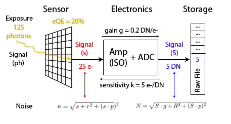

SrMi Posted June 22, 2022 Share #17 Posted June 22, 2022 1 hour ago, adan said: Expose for the highlights - expose for the highlights - expose for the highlights! Then "tame" the shadows. The M10 has enormous extra DR in the shadows. Most of the reviewers remarked on it in 2017. The M10 has a lot of DR at low ISO but, like any other camera, not so much at high ISO. At high ISO (>=1600?), it makes sense to "underexpose" one or two stops by reducing ISO, but not by reducing the exposure! On the other hand, OP is talking about summer daylight shooting, so low ISO is likely being used. Link to post Share on other sites More sharing options...
adan Posted June 22, 2022 Share #18 Posted June 22, 2022 1 hour ago, SrMi said: At high ISO (>=1600?), it makes sense to "underexpose" one or two stops by reducing ISO, but not by reducing the exposure! The only way to avoid blown highlights is to reduce the exposure (the number of photons hitting each pixel) to the point that no pixels are overloaded. Regardless of ISO. That is inescapable physics. Explain in more detail how one "shoots at ISO 1600," yet reduces the ISO to 'not 1600'. Link to post Share on other sites More sharing options...
SrMi Posted June 22, 2022 Share #19 Posted June 22, 2022 (edited) 50 minutes ago, adan said: The only way to avoid blown highlights is to reduce the exposure (the number of photons hitting each pixel) to the point that no pixels are overloaded. Regardless of ISO. That is inescapable physics. Explain in more detail how one "shoots at ISO 1600," yet reduces the ISO to 'not 1600'. Let's say the metering gives you ISO 1600, f/5.6, 1/250 sec. Let's say you want to preserve highlights by reducing exposure by one stop and shoot with 1/500 sec instead. Unfortunately, that is a bad idea, since it also increases noise. A better approach is to shoot at ISO 800 instead of ISO 1600 (f/5.6, 1/250 sec). The noise in the image, which is determined by the exposure (not ISO), stays the same. However, the image needs to be lifted by one stop in the post. This works better with raw images than with JPGs, though. Edited June 22, 2022 by SrMi Link to post Share on other sites More sharing options...

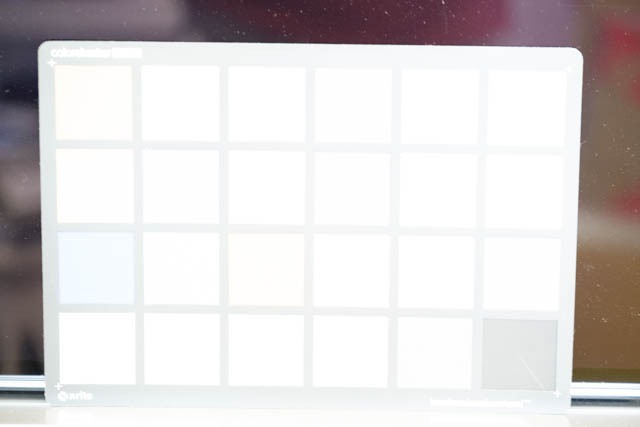

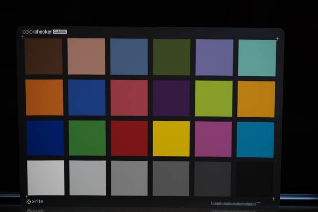

lct Posted June 22, 2022 Share #20 Posted June 22, 2022 Blown highlights can be avoided by reducing iso values w/o changing aperture or shutter speeds (Fuji X-E2, Summarit 50/2.5, 1/125s, f/2.8, 3200 & 1250 iso). Welcome, dear visitor! As registered member you'd see an image here… Simply register for free here – We are always happy to welcome new members! 1 1 Link to post Share on other sites Simply register for free here – We are always happy to welcome new members! ' data-webShareUrl='https://www.l-camera-forum.com/topic/333799-taming-blown-highlights/?do=findComment&comment=4458444'>More sharing options...
