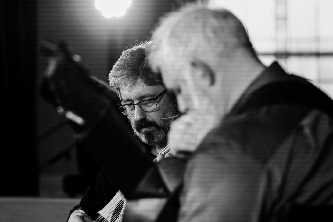

FWIW. I've tested the M11 readout speed myself by taking a picture of a lit LED lamp and then counted the bands in the image and applying simple calculation as recommended by someone else on another forum.
I used the M11 in electronic shutter mode to take a picture of a lit lamp in a dark room with a 60Hz LED bulb and was able to clearly see and count the bands/scan lines in the image. *The key for me was to do this test in a dark room with lit lamp in order to see the bands/scan lines in the image. The frame showed 12 bands/scan lines. From what I read, a light bulb using alternating current at 60Hz turns on and off 120 times per second, so I divided 120 by 12 bands = 1/10s
Too bad Leica does not publish this info as it can be important to know IMO.

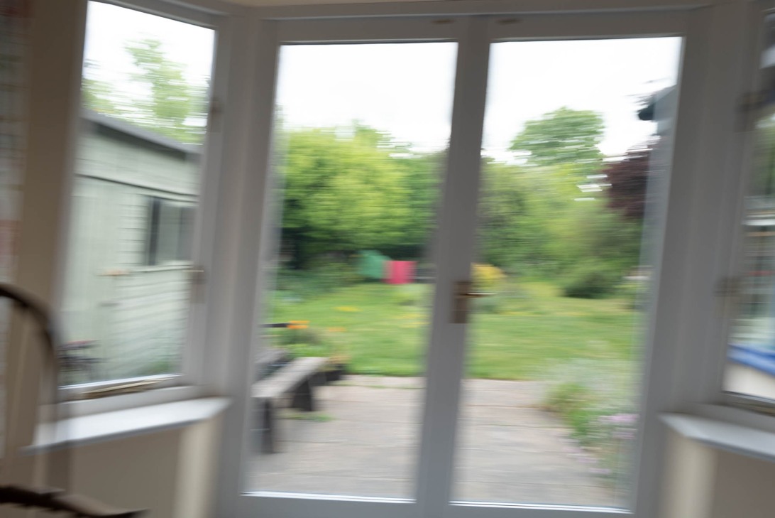

I must confess, I was surprised by how easily I was able to observe distortion using an electronic shutter (assuming that it was indeed caused by hand shake and slow readout, which I can't be 100% sure of), which I posted on the first page of this thread, but it is also true that it did not always occur -- and, perhaps more importantly, my impression is that the electronic shutter images were, in other respects, better than those taken with the mechanical shutter.

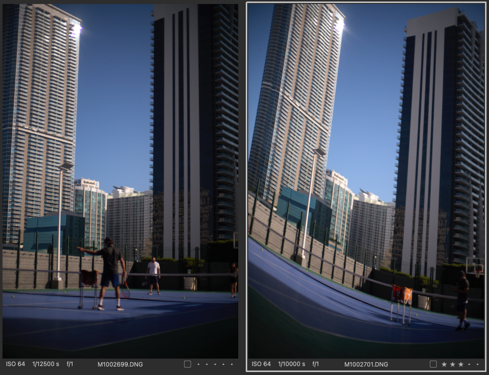

A very useful thread. Now I understand that an electronic shutter trades motion blur for distortion. So by eliminating not just shutter slap but all motion blur it is ideal for wildlife with long lenses, as distortion is a non-issue. It also explains the higher distortion with hi-res cameras. It is part of the motion blur discussion.
The warping is prominent in series of images, and you can get an ida of what the warping does in this one where it's just a portrait. Not much to the face, but the top background is quite lively. 1/500 second shutter speed, the series taken within 1 second.

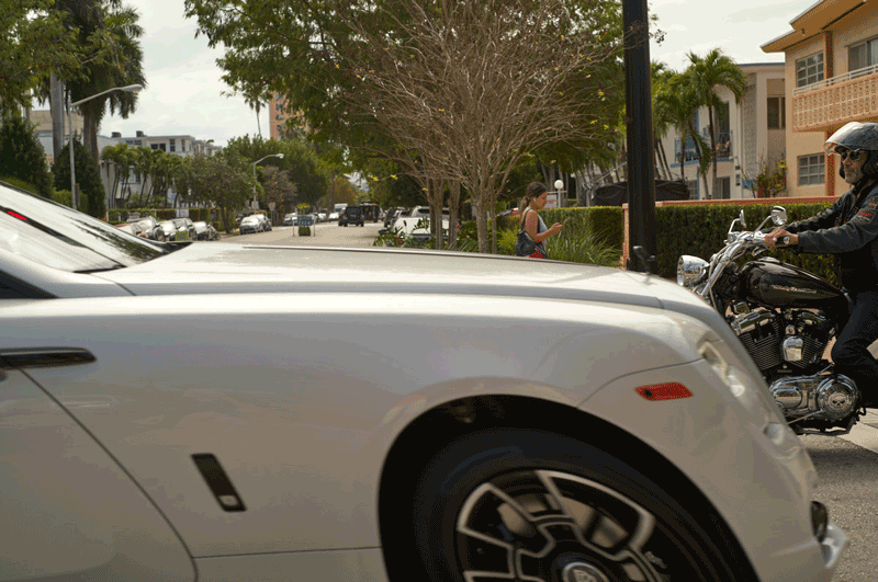

And here is another one of the warping effect of the Leica M11 electronic shutter. Camera handheld of course, and not much movement, a series taken within 2 seconds at 1/250 sec.
