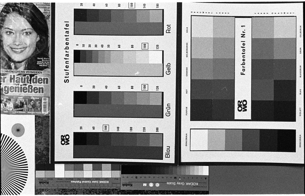

fotomas Posted April 3, 2022 Share #5 Posted April 3, 2022 Voila Welcome, dear visitor! As registered member you'd see an image here… Simply register for free here – We are always happy to welcome new members! and some 100% details: TRI-X HP5+ Both films are developed together in an home brew two bath developer, similar to Diafine. As you can see the differences are subtile. From here I would claim that HP5+ has a rather slightly coarser grain but appears a bit sharper. But this I guess can change with different developers a bit. 3 3 Link to post Share on other sites Simply register for free here – We are always happy to welcome new members! and some 100% details: TRI-X HP5+ Both films are developed together in an home brew two bath developer, similar to Diafine. As you can see the differences are subtile. From here I would claim that HP5+ has a rather slightly coarser grain but appears a bit sharper. But this I guess can change with different developers a bit. ' data-webShareUrl='https://www.l-camera-forum.com/topic/331110-hp5-vs-tri-x-pan/?do=findComment&comment=4411809'>More sharing options...

Sandokan Posted April 4, 2022 Share #7 Posted April 4, 2022 Advertisement (gone after registration) 19 hours ago, fotomas said: Voila and some 100% details: Both films are developed together in an home brew two bath developer, similar to Diafine. As you can see the differences are subtile. From here I would claim that HP5+ has a rather slightly coarser grain but appears a bit sharper. But this I guess can change with different developers a bit. Thank you for the Diafine comparison which shows a slight difference the way the two films handle red-to-blue, but I was hoping to see the results with FX-39 from the OP and to see how his language of comparison compares to the results and how I interpret them. 1 Link to post Share on other sites More sharing options...
Ornello Posted April 4, 2022 Author Share #8 Posted April 4, 2022 (edited) 9 hours ago, Sandokan said: Thank you for the Diafine comparison which shows a slight difference the way the two films handle red-to-blue, but I was hoping to see the results with FX-39 from the OP and to see how his language of comparison compares to the results and how I interpret them. I don't have a scanner capable of doing justice to the prints. Suffice it to say that HP5+ shows slightly greater contrast when the two films were processed together for 9.25 minutes in FX-39 II @68F/20C, diluted 1+14. The difference is subtle, so I think 15 seconds or maybe 30 seconds of difference in development (more for Tri-X or less for HP5+) would make them identical. The graininess of the two films is basically identical, as is sharpness (so far as can be seen in a 7X enlargement). Edited April 4, 2022 by Ornello 1 Link to post Share on other sites More sharing options...
Ornello Posted April 13, 2022 Author Share #9 Posted April 13, 2022 On 4/3/2022 at 5:01 AM, fotomas said: Voila and some 100% details: TRI-X HP5+ Both films are developed together in an home brew two bath developer, similar to Diafine. As you can see the differences are subtile. From here I would claim that HP5+ has a rather slightly coarser grain but appears a bit sharper. But this I guess can change with different developers a bit. Don't you think Kodak would have bragged about finer grain if it were true? Link to post Share on other sites More sharing options...
fotomas Posted April 13, 2022 Share #10 Posted April 13, 2022 Finer then HP5+? It's rather close and they claim the finest grain for TMax. Link to post Share on other sites More sharing options...
250swb Posted April 14, 2022 Share #11 Posted April 14, 2022 13 hours ago, Ornello said: Don't you think Kodak would have bragged about finer grain if it were true? Bragged about using Diafine to get finer grain when they have their own range of developers to sell? I guess that's why Kodak don't allow lab technicians to run the company. Link to post Share on other sites More sharing options...
Ornello Posted April 14, 2022 Author Share #12 Posted April 14, 2022 19 hours ago, fotomas said: Finer then HP5+? It's rather close and they claim the finest grain for TMax. Yes, correct. If Tri-X is finer-grained than before the change, they would certainly be hyping it. I think HP5+ is slightly finer-grained. Link to post Share on other sites More sharing options...
