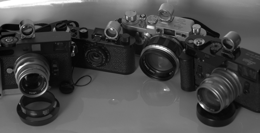

a.noctilux Posted February 25, 2022 Share #10  Posted February 25, 2022 Yes, if I remember M6 was my firtst with plastic/rubber covered eyepiece. Untill M4-P, this was metallic but if I use diopter, new ones have rubber protection same as the always falling "rubber ring" on magnifier x1.25, x1.4. Cesc, to see the world as it is, nothing can be better than SBOOI 1:1 VF from Leitz.  Not scratching glasses 😇 ...with two eyes open wearing glasses Welcome, dear visitor! As registered member you'd see an image here… Simply register for free here – We are always happy to welcome new members! Link to post Share on other sites Simply register for free here – We are always happy to welcome new members! ' data-webShareUrl='https://www.l-camera-forum.com/topic/330167-eyeglasses-m-shooters/?do=findComment&comment=4390572'>More sharing options...

a.noctilux Posted February 25, 2022 Share #14  Posted February 25, 2022 Sorry Cesc for your bank account. SBOOI in sh is not expensive comparing to other Leitz/Leica naming. Voigtlander 50 VF sibling costs even less. ... As left eye M user, side benefit of SBOOI was for me to be able to see the world with the one eye I want right or left eye or best the two 😀 with corrected eyeglasses ! Link to post Share on other sites More sharing options...
