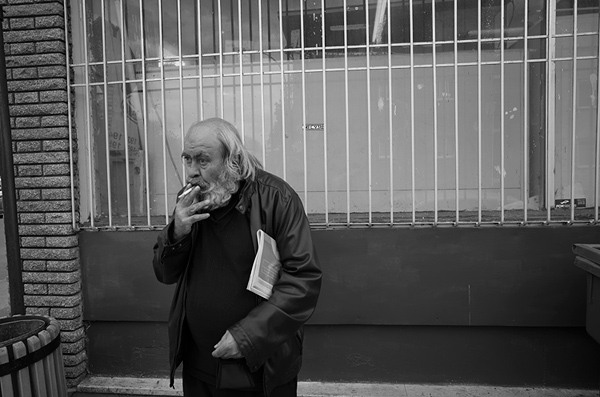

frame-it Posted June 6, 2021 Share #146 Posted June 6, 2021 i really like this shot of the man.. anyways... Welcome, dear visitor! As registered member you'd see an image here… Simply register for free here – We are always happy to welcome new members! 2 Link to post Share on other sites Simply register for free here – We are always happy to welcome new members! ' data-webShareUrl='https://www.l-camera-forum.com/topic/316688-m10m-gate-coming/?do=findComment&comment=4215088'>More sharing options...
jplomley Posted June 7, 2021 Share #147 Posted June 7, 2021 Advertisement (gone after registration) 1 hour ago, frame-it said: i really like this shot of the man.. anyways... Welcome, dear visitor! As registered member you'd see an image here… Simply register for free here – We are always happy to welcome new members! Cheers for the feedback! When there are no artifacts, it is an incredible imaging tool. Nothing else like it for B&W digital. Link to post Share on other sites More sharing options...
Likaleica Posted June 7, 2021 Share #148 Posted June 7, 2021 6 hours ago, frame-it said: i really like this shot of the man.. anyways... Welcome, dear visitor! As registered member you'd see an image here… Simply register for free here – We are always happy to welcome new members! Great beard! Link to post Share on other sites More sharing options...
