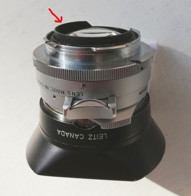

luigi bertolotti Posted November 7, 2020 Share #4 Posted November 7, 2020 (edited) 10 hours ago, blackdot said: Also, is there a way to identify which Canadian lenses do not work on the digital bodies (specifically M246) by serial number or other outward sign? By serial number, is impossible... the problem (common to all digital M) is in this black baffle : Welcome, dear visitor! As registered member you'd see an image here… Simply register for free here – We are always happy to welcome new members! Which on some items, on a very wide span of Canada items (from 60's to 90's) is shaped so that prevents to focus at infinty (not on the depicted item) ... it can easily be filed to fix the issue : even a do it yourself job provided that one protects correctly the back glass and pays attention to metal dust. 6 bit coding is doable.. even if the mount is not interchangable... I didn't paint my item, though... (tried on another lens and resulted a "dirty job",, but with right products and right tools one can achieve a good result) Btw... old lenses like mine have the plus of a std. E41 filter thread... 😉 and the OLLUX is very well made hood Edited November 7, 2020 by luigi bertolotti 2 1 Link to post Share on other sites Simply register for free here – We are always happy to welcome new members! Which on some items, on a very wide span of Canada items (from 60's to 90's) is shaped so that prevents to focus at infinty (not on the depicted item) ... it can easily be filed to fix the issue : even a do it yourself job provided that one protects correctly the back glass and pays attention to metal dust. 6 bit coding is doable.. even if the mount is not interchangable... I didn't paint my item, though... (tried on another lens and resulted a "dirty job",, but with right products and right tools one can achieve a good result) Btw... old lenses like mine have the plus of a std. E41 filter thread... 😉 and the OLLUX is very well made hood ' data-webShareUrl='https://www.l-camera-forum.com/topic/314878-35mm-summilux-pre-asph-questions/?do=findComment&comment=4075615'>More sharing options...

blackdot Posted November 7, 2020 Author Share #7 Posted November 7, 2020 (edited) Advertisement (gone after registration) 3 hours ago, luigi bertolotti said: By serial number, is impossible... the problem (common to all digital M) is in this black baffle : Welcome, dear visitor! As registered member you'd see an image here… Simply register for free here – We are always happy to welcome new members! Which on some items, on a very wide span of Canada items (from 60's to 90's) is shaped so that prevents to focus at infinty (not on the depicted item) ... it can easily be filed to fix the issue : even a do it yourself job provided that one protects correctly the back glass and pays attention to metal dust. 6 bit coding is doable.. even if the mount is not interchangable... I didn't paint my item, though... (tried on another lens and resulted a "dirty job",, but with right products and right tools one can achieve a good result) Btw... old lenses like mine have the plus of a std. E41 filter thread... 😉 and the OLLUX is very well made hood The depth of the baffle roughly matches the photos of the one I bought, so maybe I'm ok! 59 minutes ago, tommonego@gmail.com said: I have one that I purchased back in the 1970's (for around $300), I had always used a slipon series 6 filter adapter and had amodified 12585 lens shade. When a couple of years ago I looked for the proper lens shade 12504, I was surprised that the Leica ones were going for $200 and more. I did find a Chinese copy for $40, not Leica construction but works. I have series 7 filters which it was made for, but I also use 49mm filters. One problem is my infrared 49mm doesn't fit well and I have to be careful when setting it up as the thereads barely connect. If the slip on S-VI adapter works, then that it a very cheap solution! I even have a Leica UV for S-VI from an old Leicaflex lens.Ordered. 4 hours ago, Raymondl said: I have this lens. I purchased this back in 2017 for what I thought was a decent price. I don’t understand why it has gone up so much since then. back to the question. My lens came with the series 7 filter and hood. Looking online for a reasonable replacement I came across this - https://www.ebay.com.au/itm/Metal-Lens-Hood-for-Leica-12504-Summilux-Summicron-M-35mm-1-1-4-1-2-Lens-Black/152375063917?hash=item237a42f56d:g:KecAAOSwgZ1XrHu9 Did you order a hood with the ability to accept series 7 filters ? As for a series 7 filter replacements I found this thread - my issue now is my lens hood + filter is fairly expensive to replace (if I lose it)... I ordered the same Chinese hood as in your link. I wonder if it also takes 49mm like the original? Edited November 7, 2020 by blackdot Link to post Share on other sites More sharing options...

UliWer Posted November 7, 2020 Share #12 Posted November 7, 2020 vor 19 Stunden schrieb blackdot: ... Also, is there a way to identify which Canadian lenses do not work on the digital bodies (specifically M246) by serial number or other outward sign? I don‘t think you can identify by numbers whether a certain lens has the problems with the „baffle“ described by Luigi above. You have to try with your camera. There are differences between the digital M camera bodies. My canadian Summilux No. 3081435 does not work properly with the M9, but it does with the M10 and M10 Monochrom. The M10 - with a slimmer body - has a protruding bayonet ring, which the other digital bodies don‘t have. This helps, though I‘d recommend to try even with an M10 body before buying the Summilux. (Same with the dual scale 50mm Summicron). It is said that the later Leitz Wetzlar examples of the Summilux don‘t have the problem. I was looking for a long time to find one, but was reluctant since they are rarer and more expensive (the Summilux already being way too expensive on the second hand market...), so I was happy to find a Candian version which works with the M10. 1 Link to post Share on other sites More sharing options...
blackdot Posted November 7, 2020 Author Share #13 Posted November 7, 2020 Just now, UliWer said: I don‘t think you can identify by numbers whether a certain lens has the problems with the „baffle“ described by Luigi above. You have to try with your camera. There are differences between the digital M camera bodies. My canadian Summilux No. 3081435 does not work properly with the M9, but it does with the M10 and M10 Monochrom. The M10 - with a slimmer body - has a protruding bayonet ring, which the other digital bodies don‘t have. This helps, though I‘d recommend to try even with an M10 body before buying the Summilux. (Same with the dual scale 50mm Summicron). It is said that the later Leitz Wetzlar examples of the Summilux don‘t have the problem. I was looking for a long time to find one, but was reluctant since they are rarer and more expensive (the Summilux already being way too expensive on the second hand market...), so I was happy to find a Candian version which works with the M10. The seller told me it works fine on his M10, and from the pictures, the baffle does not look especially deep, so it will probably be ok on the M246. I'll find out soon! Link to post Share on other sites More sharing options...
UliWer Posted November 7, 2020 Share #14 Posted November 7, 2020 Please be careful! As far as I know the M246 has no protruding ring for the bayonet like the M10. So I don‘t find a reason why your lens should work properly - unless it is altered. 1 Link to post Share on other sites More sharing options...
luigi bertolotti Posted November 7, 2020 Share #15 Posted November 7, 2020 (edited) Surely this issue has been discussed in depth in the forum...don't remember when but probably 10 years ago or similar 🙄 (I seem was still when I had M8...) but I remember that some people did report how they solved the problem (which I think can still fixed by Leica CS - but probably at a no little cost... - my M240 manual says like this in the "lens compatibility" section) Edited November 7, 2020 by luigi bertolotti 1 Link to post Share on other sites More sharing options...
blackdot Posted November 7, 2020 Author Share #16 Posted November 7, 2020 38 minutes ago, UliWer said: Please be careful! As far as I know the M246 has no protruding ring for the bayonet like the M10. So I don‘t find a reason why your lens should work properly - unless it is altered. Of course! Close focus first, then slow turn to infinity.. Link to post Share on other sites More sharing options...
