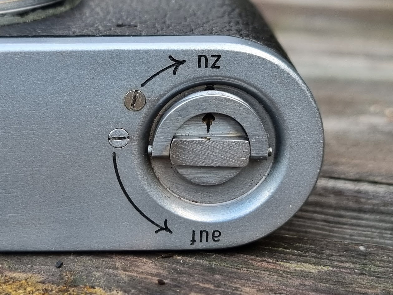

I present to you a Leica IA that was rechromed somewhere about 1936 or after (the date of the Elmar lens) by a third party. According to Leitz the camera was shipped on the 10th of May, 1927 to Calderoni & Társa in Budapest (a well-known photo store).
It still retains most of the original details, but it was apparently also re-engraved (the engraving is of a very high quality though!). Some of the original details include:
- Feathered, low profile knobs
- Flat screw on the A/R lever
- First version of the baseplate lock
- Original coarse vulcanite (still uncracked!) with holes for the infinity lock.
- Top plate is held by four screws,
The mount does not have the "O".
I have used my Leica I model C (do not have another A) for the comparison photos.
