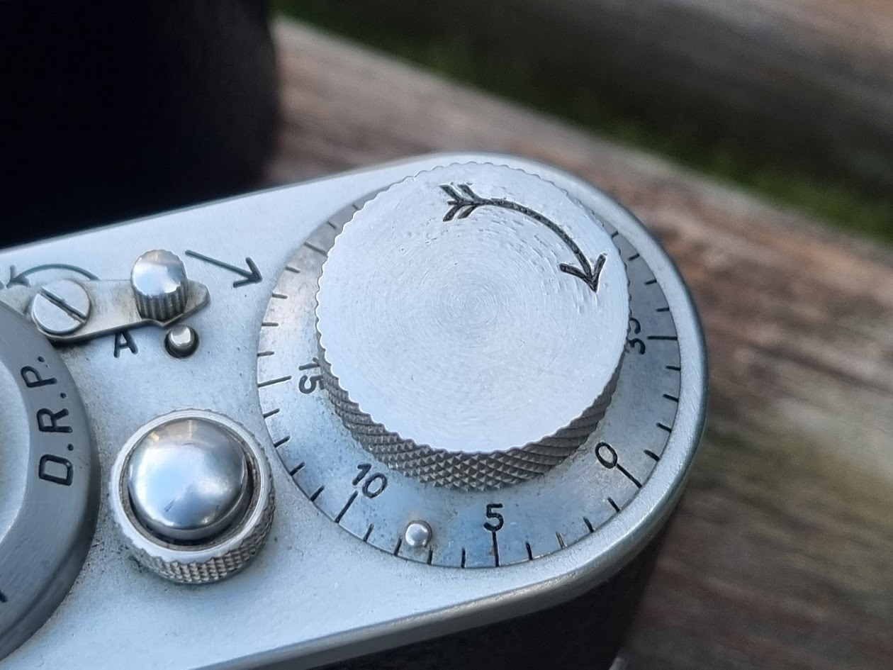

In some other threads such cameras appear but I think we should give them an own thread. So I just  want to share some pictures, let's start with a Leica I form 1931 upgrades to a Leica II:
The lens, still without number, has an IR-Index so the conversion might be done after 1935, body has no hidden window on the back the model with fixed lens needed to adjust, no "toilet-seat"-window either; what yo cannot see is an ugly "wild" flash sync at the rear beneth the accessory-shoe.

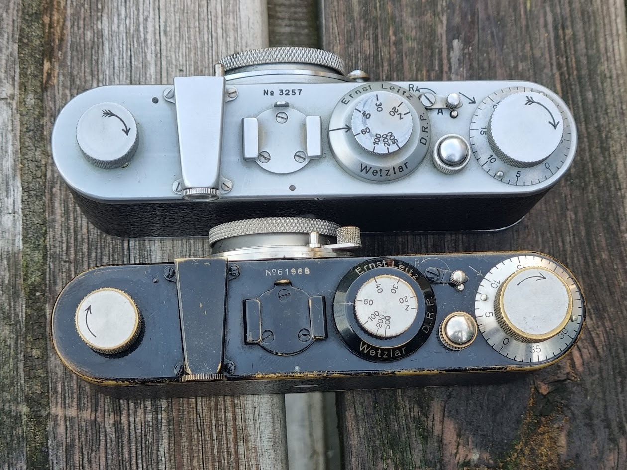

A Leica I from 1929 converted to Model II and flash-synced at the factory
Wind- and rewind-knobs are chrome, body vastly modiefied as the coverd hole for long-time-selector for Model III indicates, no screw on top at flash-number 11 position. The glas from the original lens without number was remounted in a new body with new f-stops running to f16 and the scales are red with diamond-shaped Index, no coating added though.

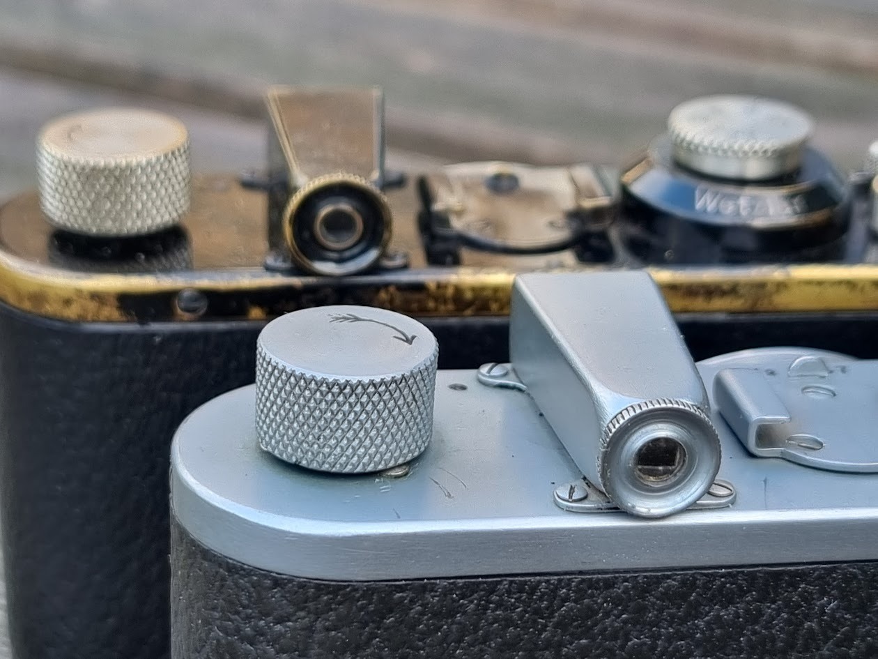

All the above shown cameras have remounted lenses, all looking different
Left the nickel on from 1931, the one from 1930 modified around 1950, the early one from 1929 modified to red-scale diamond and one from 1937 coated later
note the different height from formerly fixed lenses in the middle to the later

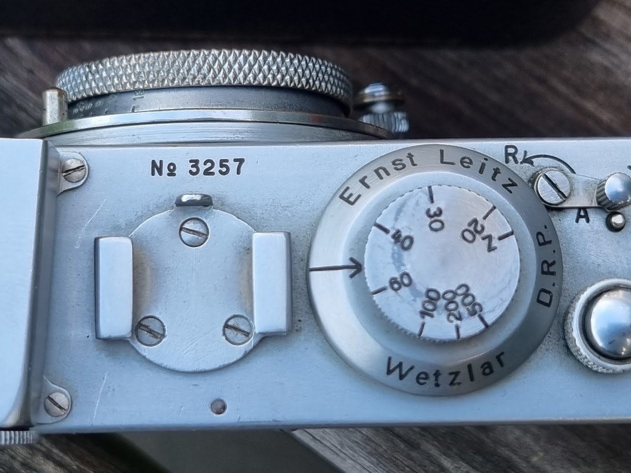

Leica IIc sharkskin from 1948 modified to IIIf
This one got the long exposure times but no new top, just the scale for the flash-bulbs was screwed on
Comparing the top of fash-modified
the already shown two black ones without screw at 11 on the left, with that screw both black and chome in the middle means new top-plate and far right the one with screwed-on plate.

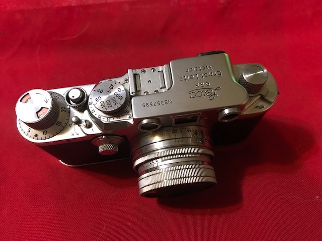

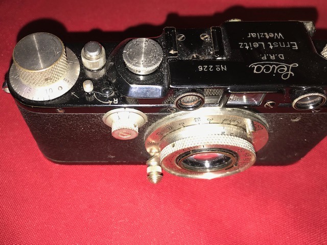

I have about 37 leica cameras that have been upgraded. Within pre-war cameras, the earliest I have is a Model 1 originally an Anistigmat No. 226 which has been upgraded to a model IIIa. Per the list of conversions above in post 9, the conversion to IIIa was not allowed in 1935, perhaps later it was available. With regular production starting at No, 130 or so, this would be the 96th or 97th Leica made after the prototypes. The latest pre-war conversion/upgrade I have is No. 397599, a IIIc with flash syncronization added. See photos. Post-war the addition of sync and the upgrade of model Ic, If and IIc and IIf, and Ig to higher models was popular. Does anyone have an M1 camera that was upgraded to an M3, I believe this was an available option.

Alan, that 226 is simply amazing.
Very nice, Alan. Does it still have the original Anastigmat lens head after the 7 O'Clock conversion and other changes? Other points are whether it has a serial number on the lens and whether the lens is noticeably short.

The latest pre-war conversion/upgrade I have is No. 397599, a IIIc with flash syncronization added...
Alan, it is one of the last wartime IIIc! Amazing.
The one that I have is 397635 - not far away from number point of view, but years after yours....
Notice sharkskin covering. This was former Betriebskamera, number 063 may be found inside so originally from 1950/51. In 1965 was updated with all features of later IIIf, received new top cover with until now unused serial numbers
When talking about adding flash sync to wartime IIIc - it was done almost exclusively by adding small plate to existing top cover. I have seen only 3 wartime IIIc with flash sync added by Leitz where top cover has been replaced  to one without step, of course. Here is one of them
Mounting postwar top cover on wartime IIIc was not trivial, camera crate had to be renewed as well and with this as well most of the internal mechanisms. In case of above IIIc almost the whole camera was renewed, similarly to conversions from IA to IIIa syn (shown by romanus). Conversion catalogue from 1954 specify, that for cameras with SN above 400000 IIIc Type 2) renewing top cover for flash sync was 18DM in addition. Renewing top cover for IIIc Type 1 was on special order only
