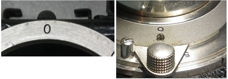

jerzy Posted October 31, 2022 Share #27 Posted October 31, 2022 Advertisement (gone after registration) why someone made a hole close to 1,7m is unknown to me, for sure not at Leitz. "0" at 12 oclock means that the camera has standard distance flange - film plane and allowed to une any Leica lens that has standartised mount (as well marked with "0", see examples below. I do not see 0 on DOF, is there any other other number, apart apertures, possibly "497" engraved on DOF? "0" markings were done until approx 1939 on lenses and flanges, disappeared with IIIc Welcome, dear visitor! As registered member you'd see an image here… Simply register for free here – We are always happy to welcome new members! Marking at 9 oclock is fine. Yes, lens flange should have been nickeled, unless conversion was done after 1946 1 Link to post Share on other sites Simply register for free here – We are always happy to welcome new members! Marking at 9 oclock is fine. Yes, lens flange should have been nickeled, unless conversion was done after 1946 ' data-webShareUrl='https://www.l-camera-forum.com/topic/306991-double-feathered-arrows-on-the-leica-1a/?do=findComment&comment=4550917'>More sharing options...

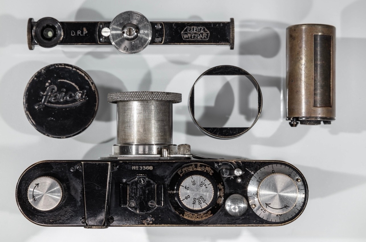

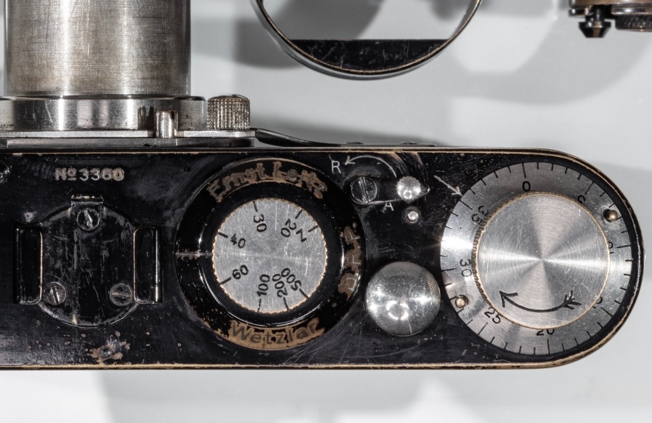

Leica_Guy_Dallas Posted March 11, 2024 Share #35 Posted March 11, 2024 My Model I is No. 3360. The film advance has double arrows and the rewind has triple arrows. Welcome, dear visitor! As registered member you'd see an image here… Simply register for free here – We are always happy to welcome new members! 3 Link to post Share on other sites Simply register for free here – We are always happy to welcome new members! ' data-webShareUrl='https://www.l-camera-forum.com/topic/306991-double-feathered-arrows-on-the-leica-1a/?do=findComment&comment=5089452'>More sharing options...

Leica_Guy_Dallas Posted October 23 Share #40 Posted October 23 My #3360 from 1827 has double arrows. Welcome, dear visitor! As registered member you'd see an image here… Simply register for free here – We are always happy to welcome new members! 1 Link to post Share on other sites Simply register for free here – We are always happy to welcome new members! ' data-webShareUrl='https://www.l-camera-forum.com/topic/306991-double-feathered-arrows-on-the-leica-1a/?do=findComment&comment=5880006'>More sharing options...
