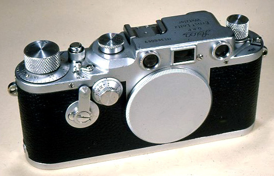

jerzy Posted February 11, 2020 Share #12 Posted February 11, 2020 Leica always engraved SN under the top cover, in case of Betriebskameras the were marked as well accordingly on the internal frame. From outside everything looks good, as well "N" in SN engraving is of the style correct for the time. Final prove needfs camera to be disassembled, but what would help now is the photo of film chamber with take up spool taken off 1 Quote Link to post Share on other sites More sharing options...
Pecole Posted February 11, 2020 Share #13 Posted February 11, 2020 (edited) "My" Leica IIId (code LOOTP), in my former Fontenelle collection, had serial 360069 and was authentified by Leitz as manufectured in 1942. The company provided this extract of their production records and precised that early models had black shutter blinds and no slow speed dial lock. Note that 360001 is not mentioned, but it not means anything - even not that it was the first - since the 360029 was produced in 1939 and the 360010 in 1947! The attribution of serials does definitely not follow a logical order. My guess - it is purely a guess - is that the serial 360001 is probably a late production (1947 or even later?). Welcome, dear visitor! As registered member you'd see an image here… Simply register for free here – We are always happy to welcome new members! Edited February 11, 2020 by Pecole Quote Link to post Share on other sites Simply register for free here – We are always happy to welcome new members! ' data-webShareUrl='https://www.l-camera-forum.com/topic/306346-auction-find/?do=findComment&comment=3910735'>More sharing options...
willeica Posted February 11, 2020 Share #14 Posted February 11, 2020 4 minutes ago, Pecole said: My guess - it is purely a guess - is that the serial 360001 is probably a late production (1947 or even later?). While I agree about the sequence of Leica SNs, this could equally have been a 'prototype' or 'works camera' picked up from the factory and brought to the US by a returning GI , as suggested by Jim Lager. Wetzlar seems to have been in the US zone. The comment on the register, about the self timer and seen by Jim Lager, could have been a reference to the fact that this was a IIIc with a self timer or, indeed, that this was one of the first Leicas with a self timer, ie the first IIId. As suggested by Jim Lager and Jerzy, this camera needs to be stripped down and examined. William 1 Quote Link to post Share on other sites More sharing options...

Pecole Posted February 11, 2020 Share #17 Posted February 11, 2020 (edited) 25 minutes ago, Pecole said: "My" Leica IIId (code LOOTP), in my former Fontenelle collection, had serial 360069 and was authentified by Leitz as manufectured in 1942. The company provided this extract of their production records and precised that early models had black shutter blinds and no slow speed dial lock. Note that 360001 is not mentioned, but it not means anything - even not that it was the first - since the 360029 was produced in 1939 and the 360010 in 1947! The attribution of serials does definitely not follow a logical order. My guess - it is purely a guess - is that the serial 360001 is probably a late production (1947 or even later?). Welcome, dear visitor! As registered member you'd see an image here… Simply register for free here – We are always happy to welcome new members! Is it an effect of age? I forgot to mention that I also had for some time a Leica IIId nº367308 (1944) with a red blind. Following van Hasbroeck, it was part of a batch (nº 367305-367324) delivered to the Nippon naval attaché in Berlin in 1944. Here are photos. Edited February 11, 2020 by Pecole 1 Quote Link to post Share on other sites More sharing options...
