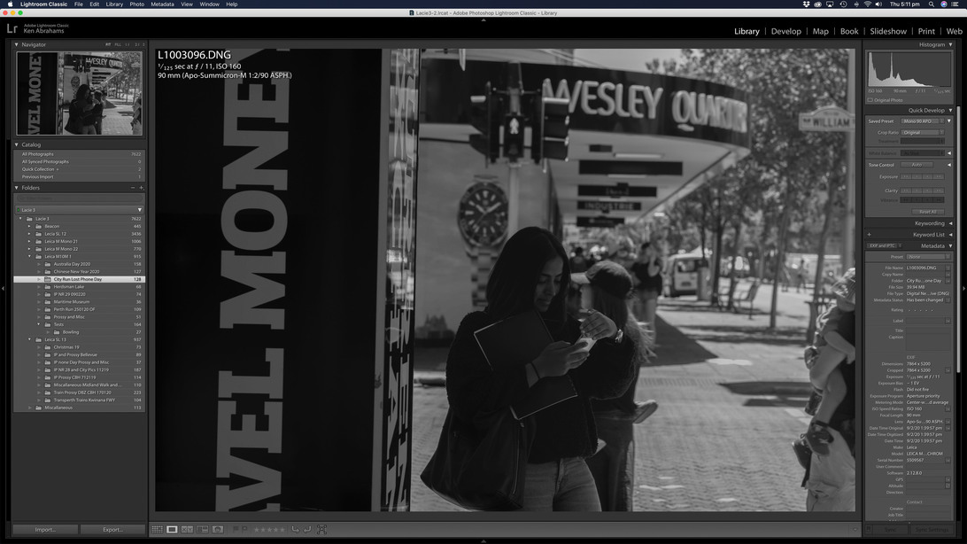

Ken Abrahams Posted February 8, 2020 Share #8 Posted February 8, 2020 I use LR to add sharpness and lens profile only then go to Photoshop for curves and tonal processing using layers and masking tools. Depending on the type of image I will further process in Silver Effex but not always. 2 Link to post Share on other sites More sharing options...
