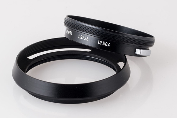

MikeMyers Posted February 3, 2020 Author Share #10 Posted February 3, 2020 4 minutes ago, lct said: Just for a reminder. I assumed you guys meant I would drop in a series 7 filter from the back. How do I "open the hood"? Are there any instructions posted here? Never tried that - maybe that's my problem. Link to post Share on other sites More sharing options...
lct Posted February 3, 2020 Share #11 Posted February 3, 2020 3 minutes ago, MikeMyers said: I assumed you guys meant I would drop in a series 7 filter from the back. How do I "open the hood"? Are there any instructions posted here? Never tried that - maybe that's my problem. The hood is made of two halves. You just need to unscrew them. Welcome, dear visitor! As registered member you'd see an image here… Simply register for free here – We are always happy to welcome new members! Link to post Share on other sites Simply register for free here – We are always happy to welcome new members! ' data-webShareUrl='https://www.l-camera-forum.com/topic/306038-does-m82-have-a-built-in-ir-cut-filter/?do=findComment&comment=3905003'>More sharing options...

MikeMyers Posted February 3, 2020 Author Share #19 Posted February 3, 2020 1 hour ago, lct said: The hood is made of two halves. You just need to unscrew them. Welcome, dear visitor! As registered member you'd see an image here… Simply register for free here – We are always happy to welcome new members! Thank you - I didn't know it came apart like this. Will check it out tomorrow. Link to post Share on other sites More sharing options...
