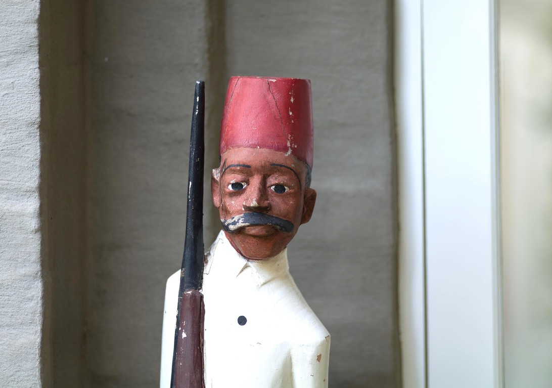

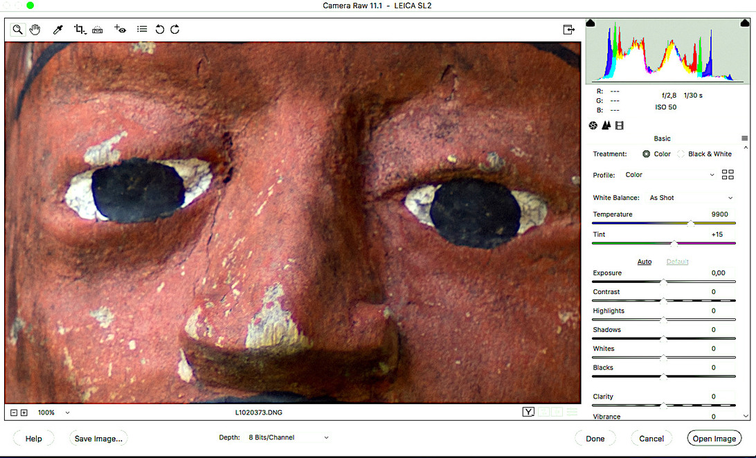

Chaemono Posted January 20, 2020 Share #1  Posted January 20, 2020 (edited) Advertisement (gone after registration) It has been stated before that IBIS + OIS is only available when a 'native' lens is mounted on either the SL2 or the S1R/S1, i.e. a Leica lens with OIS on the SL2 and a Lumix FF lens with OIS on the S1/R.  If one attaches a Leica lens with OIS, like the 90-280 APO-VE-SL, for example, to a Panasonic body, one has the choice of Lens OIS, Body IBIS, or Off.  If one attaches a Panasonic lens with OIS to a Panasonic body, one has a choice of Lens OIS, Body IBIS, or both.  With the SL2, Leica reduced it to a choice of either Stabilzation On or Off.  I mounted the 90-280 APO-VE-SL on the SL2 in order to shoot some windows in a cathedral and also to see how effectively Stabilization On works when both, the lens and the sensor, are stabilized.  I shot mostly in horizontal mode because I could hold the combo more steadily this way (don't have the handgrip).  I was really impressed with how well the combination of IBIS + OIS worked.  I managed to get one sharp shot handheld at 260 mm with a shutter speed of only 1/20 sec.  You can see all of the pictures here: https://chaemono.smugmug.com/SL2-light-and-color/.  The fact that combined IBIS + OIS only functions with Panasonic lenses on the S1/R and with SL lenses on the SL2 may be a compelling enough reason to use the 'native' OIS zooms with the respective cameras, IMO. Here are less compressed JPEGs of the two below: https://www.smugmug.com/gallery/n-TN53T9/ SL2 + 90-280 APO-VE-SL handheld at 260 mm Welcome, dear visitor! As registered member you'd see an image here… Simply register for free here – We are always happy to welcome new members! ISO 400 f/4 @/1/20 sec. Crop from above  Edited January 20, 2020 by Chaemono 1 Link to post Share on other sites Simply register for free here – We are always happy to welcome new members! ISO 400 f/4 @/1/20 sec. Crop from above  ' data-webShareUrl='https://www.l-camera-forum.com/topic/305525-sl2-how-effective-is-ibis-ois/?do=findComment&comment=3895379'>More sharing options...

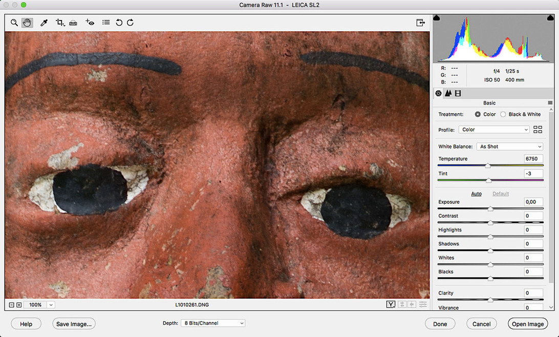

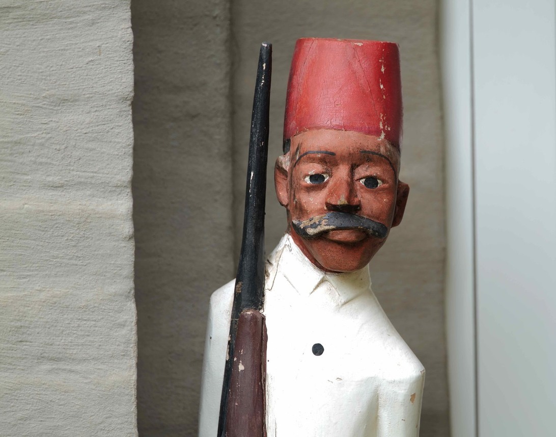

scott kirkpatrick Posted January 20, 2020 Share #2  Posted January 20, 2020 (edited) Evaluating stabilization is tricky. The number of stops that camera makers are allowed to quote are based on a camera secured to a vibrating test table which plays a standard series of motions thought to simulate a proper range of user shakes. I think (but am not entirely sure) that a 50 mm lens and a test target at a few feet distance are used. The shooter's own stability is a factor, just as it is in marksmanship with a rifle. Standing up is harder than sitting, and prone is best. You are getting a shutter speed about four stops lower than 1/f -- was every shot at 1/20 this sharp or is this the best of several? Were you sitting or standing? I find the 90-280 pretty heavy and hard to steady when standing and shooting at a tree 50 m above me. I got steadier results using the SL2 and an R 180/2.8, which is lighter but has no OIS. Sitting inside with the SL2 and the APO SC 50 SL, shooting at a wall of books 2 m away, I got half my shots sharp at 1.5 seconds exposure, all of them sharp at 1 sec. That's about 6 stops under pretty favorable conditions. Do we know that the SL2 uses both IBIS and OIS on the two SL zooms? I think I saw that David Farkas said so, but I would prefer to hear it from Wetzlar directly. Otherwise I would suspect that this may be on the list for a future firmware upgrade. Edited January 20, 2020 by scott kirkpatrick Link to post Share on other sites More sharing options...
Chaemono Posted January 20, 2020 Author Share #3  Posted January 20, 2020 (edited) vor 22 Minuten schrieb scott kirkpatrick: [...] -- was every shot at 1/20 this sharp or is this the best of several? Were you sitting or standing? [...] No, not every shot but quite a few. This was one of the best.  I was standing because the windows are high up behind columns (see here: https://www.spottinghistory.com/view/3744/mainz-cathedral/).  In the gallery (first link) there are three shots at 1/30 sec., one at 236 mm, one at 271 mm, one at 268 mm.  The 236 mm is about equally sharp, the other two are good enough unless one zooms in 3:1.  There is one at 1/25 sec. at 253 mm, also impressive.  I did shoot each window about six to eight times.  Went back to some of them and repeated. I was in there for about 45 minutes. Edited January 20, 2020 by Chaemono Link to post Share on other sites More sharing options...
