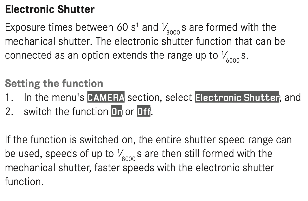

frame-it Posted November 8, 2019 Share #4 Posted November 8, 2019 24 minutes ago, johnbuckley said: you can shoot with either a mechanical or electronic shutter - or a hybrid where after 1/8000th it uses the latter. the SL1 has that option too? Welcome, dear visitor! As registered member you'd see an image here… Simply register for free here – We are always happy to welcome new members! Link to post Share on other sites Simply register for free here – We are always happy to welcome new members! ' data-webShareUrl='https://www.l-camera-forum.com/topic/303248-hybrid-mechanicalelectronic-shutter/?do=findComment&comment=3850343'>More sharing options...

evikne Posted November 8, 2019 Share #6 Posted November 8, 2019 (edited) 2 hours ago, frame-it said: the SL1 has that option too? Welcome, dear visitor! As registered member you'd see an image here… Simply register for free here – We are always happy to welcome new members! 1/6000 should perhaps be 1/16000 sec? Not much of an extension otherwise. Edited November 8, 2019 by evikne Link to post Share on other sites More sharing options...
NigelG Posted November 8, 2019 Share #7 Posted November 8, 2019 Advertisement (gone after registration) 1 hour ago, evikne said: 1/6000 should perhaps be 1/16000 sec? Not much of an extension otherwise. Or maybe higher still? The TL2 goes to 1/40,000 in hybrid mode... Link to post Share on other sites More sharing options...
