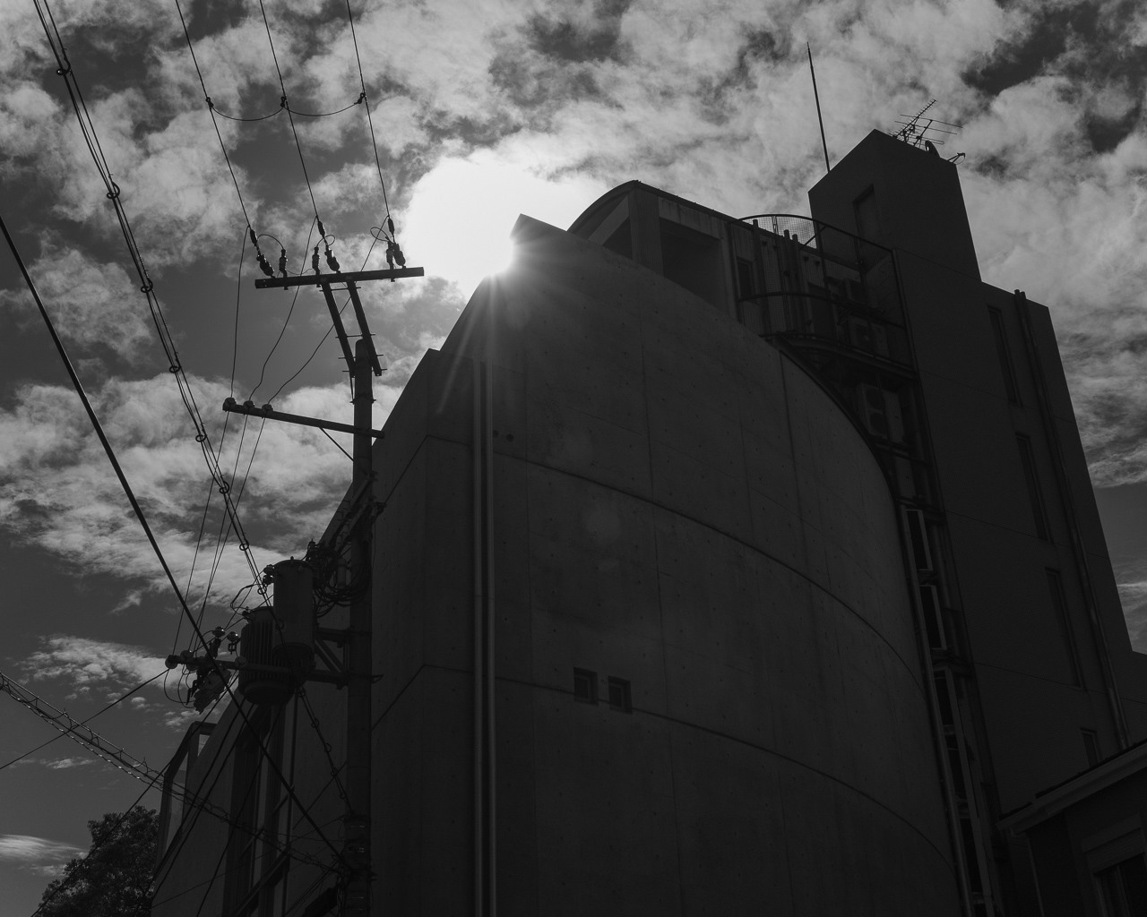

frame-it Posted September 15, 2019 Share #13 Posted September 15, 2019 Fuji GFX50R + Leica 50mm Summilux-M ASPH ACROS-RED Jpg from Camera..cropped F11, ISO 100, 1/500th, FULL 8256x6192 resized to 1280 for the forum, shadow lift Welcome, dear visitor! As registered member you'd see an image here… Simply register for free here – We are always happy to welcome new members! Link to post Share on other sites Simply register for free here – We are always happy to welcome new members! ' data-webShareUrl='https://www.l-camera-forum.com/topic/301518-why-no-m-lenses-on-leica-s-system/?do=findComment&comment=3820796'>More sharing options...
frame-it Posted September 15, 2019 Share #14 Posted September 15, 2019 Fuji GFX50R + Leica 50mm Summilux-M ASPH ACROS-RED Jpg from Camera..cropped F11, ISO 100, 1/500th, resized to 1280 for the forum and a bit of cropping [4x5/8x10] to > 7222x5778 Welcome, dear visitor! As registered member you'd see an image here… Simply register for free here – We are always happy to welcome new members! 1 1 Link to post Share on other sites Simply register for free here – We are always happy to welcome new members! ' data-webShareUrl='https://www.l-camera-forum.com/topic/301518-why-no-m-lenses-on-leica-s-system/?do=findComment&comment=3820798'>More sharing options...
alan.y Posted September 16, 2019 Share #15 Posted September 16, 2019 (edited) Thanks. That looks good even though cropped to 5:4. Do you also have one in color and at f/4 or something? Edited September 16, 2019 by alan.y Link to post Share on other sites More sharing options...
frame-it Posted September 16, 2019 Share #16 Posted September 16, 2019 thanks, its the office building of a very famous architect "Tadao Ando" ill have to look carefully shot over 2000 pics in 3 days and no Aperture data, i only noted down at some specific locations..i think the adapter is very important too..i use the novoflex : https://www.novoflex.de/en/products-637/lens-adapters//adapterfinder-products/fuji-g-mount-mirrorless/adapter-leica-m-lenses-to-fuji-g-mount-cameras.html Link to post Share on other sites More sharing options...

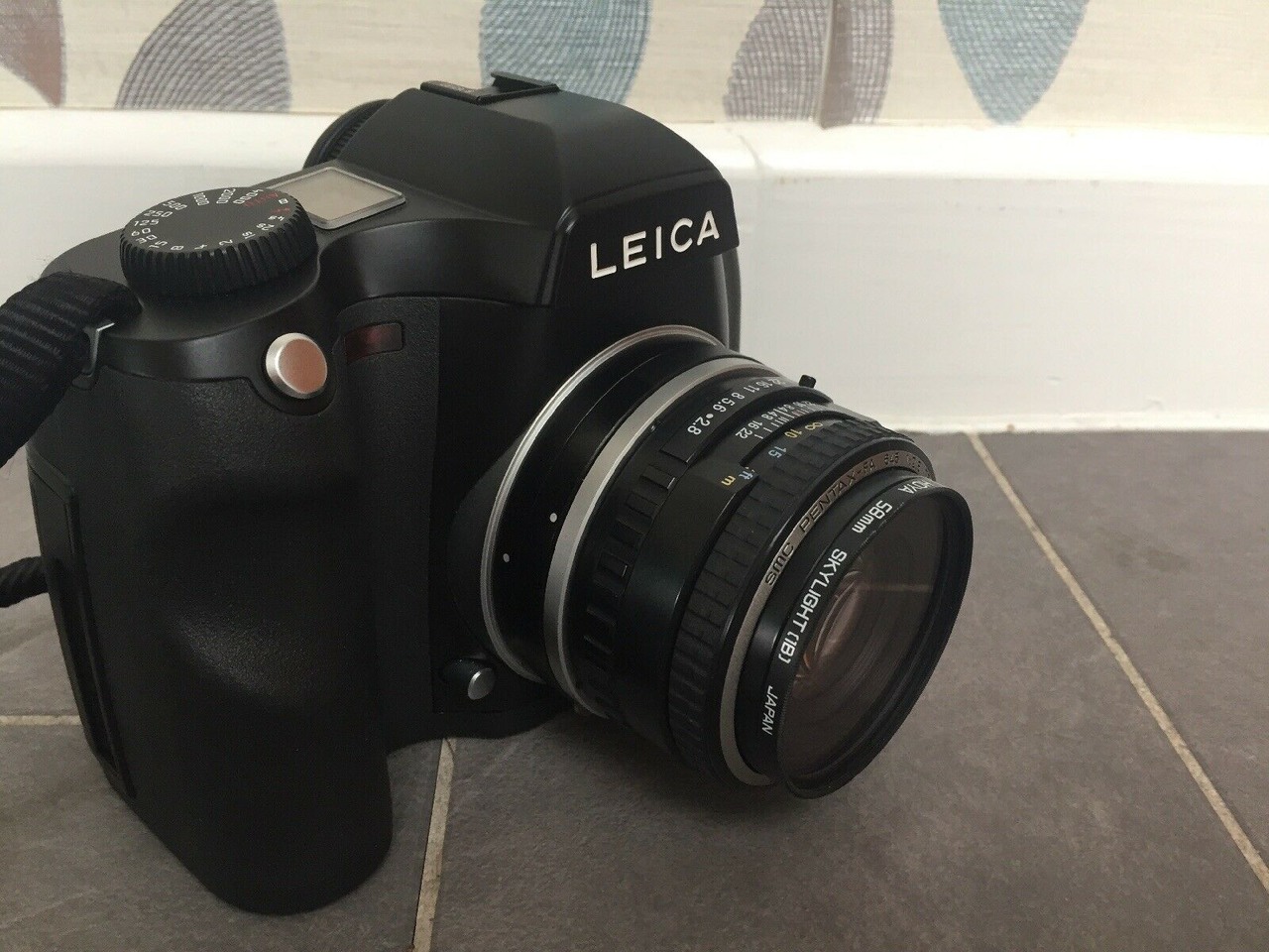

Sarnian Posted September 16, 2019 Share #18 Posted September 16, 2019 I think the smallest lens you can use on the Leica S system is the Pentax 645 A 75mm. It works great (manual focus only). The Pentax 645 A 35mm is a great performer so my travel kit is both of these little lenses. Mark P.S. Fotodiox makes a Leica L39 Visoflex adapter but I can't get my head around what's needed to use that set up! https://fotodioxpro.com/collections/lens-mount-adapters/products/l39-viso-ls-pro Welcome, dear visitor! As registered member you'd see an image here… Simply register for free here – We are always happy to welcome new members! 3 1 Link to post Share on other sites Simply register for free here – We are always happy to welcome new members! ' data-webShareUrl='https://www.l-camera-forum.com/topic/301518-why-no-m-lenses-on-leica-s-system/?do=findComment&comment=3821031'>More sharing options...
ropo54 Posted September 16, 2019 Author Share #19 Posted September 16, 2019 Mark, Which adapter you do use to accommodate the Pentax 645 lens on your S? Thanks, Rob 22 minutes ago, Sarnian said: I think the smallest lens you can use on the Leica S system is the Pentax 645 A 75mm. It works great (manual focus only). The Pentax 645 A 35mm is a great performer so my travel kit is both of these little lenses. Mark P.S. Fotodiox makes a Leica L39 Visoflex adapter but I can't get my head around what's needed to use that set up! https://fotodioxpro.com/collections/lens-mount-adapters/products/l39-viso-ls-pro Welcome, dear visitor! As registered member you'd see an image here… Simply register for free here – We are always happy to welcome new members! 1 Link to post Share on other sites More sharing options...
Sarnian Posted September 16, 2019 Share #20 Posted September 16, 2019 27 minutes ago, ropo54 said: Mark, Which adapter you do use to accommodate the Pentax 645 lens on your S? Thanks, Rob Hi Rob, From reading a thread on here ip’s (William) did the legwork for me and a clever person in Hong Kong custom machined it. Really good quality and the lenses fit perfectly with zero play or wobble. I’m getting the same quality with the lenses that I previously used on my Pentax 645Z. That might not mean Leica quality but being able to put a 35mm AND a 75mm lens in a small camera bag is very liberating. I’ve also used the Pentax FA 33-55mm (in manual focus mode). Mark Link to post Share on other sites More sharing options...
