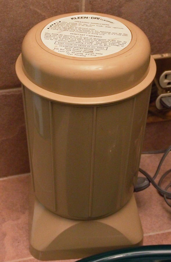

chrism Posted June 12, 2019 Share #10 Posted June 12, 2019 Since I switched to the motorised Rondinax 35 and 60, the large diameter film reels won't fit in my old Kleen-Dri, which takes Paterson or metal reels (one at a time). It has a canister of silica gel in it, a heating element and a fan. Films dry in 20-30 minutes. I leave the can of silica gel crystals in the oven between uses so they are always dehydrated whenever I cook. Welcome, dear visitor! As registered member you'd see an image here… Simply register for free here – We are always happy to welcome new members! 1 Link to post Share on other sites Simply register for free here – We are always happy to welcome new members! ' data-webShareUrl='https://www.l-camera-forum.com/topic/298113-diy-film-dryer/?do=findComment&comment=3758316'>More sharing options...

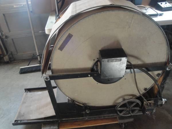

RayD28 Posted August 6, 2019 Share #18 Posted August 6, 2019 Came across this from craigslist. Anyone know if these were good and worth further investigation? Welcome, dear visitor! As registered member you'd see an image here… Simply register for free here – We are always happy to welcome new members! Link to post Share on other sites Simply register for free here – We are always happy to welcome new members! ' data-webShareUrl='https://www.l-camera-forum.com/topic/298113-diy-film-dryer/?do=findComment&comment=3792370'>More sharing options...
Pyrogallol Posted August 6, 2019 Share #19 Posted August 6, 2019 (edited) 4 hours ago, RayD28 said: Came across this from craigslist. Anyone know if these were good and worth further investigation? Welcome, dear visitor! As registered member you'd see an image here… Simply register for free here – We are always happy to welcome new members! Looks like an old print drier/glazer for use with real paper, last used in the 1970’s, or something for drying clothes? not for drying film. I just hang my film up and let it dry naturally. Edited August 6, 2019 by Pyrogallol Link to post Share on other sites More sharing options...
