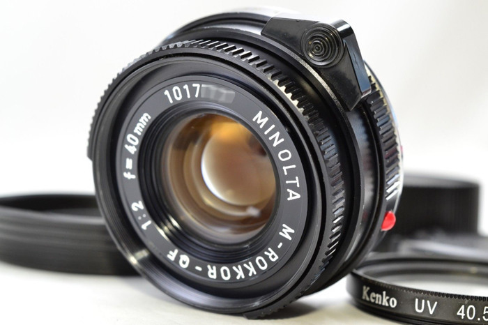

One LCF Posted May 24, 2019 Author Share #9 Posted May 24, 2019 (edited) vor 4 Stunden schrieb AceVentura1986: Do the two versions have distinct markings so as to distinguish them? If not, then how can you tell? The earlier version (CL; with sloped cam, single coating) had marked its serial number on the front ring, like Leitz / Leica lenses are marked. The later version had its serial number on the lens barrel (CLE; with even cam, multicoated), so no serial number on the front ring. Edited May 24, 2019 by One LCF 2 Quote Link to post Share on other sites More sharing options...

lct Posted May 24, 2019 Share #13 Posted May 24, 2019 3 hours ago, One LCF said: The earlier version (CL; with sloped cam, single coating) had marked its serial number on the front ring, like Leitz / Leica lenses are marked. The later version had its serial number on the lens barrel (CLE; with even cam, multicoated), so no serial number on the front ring. Also the focus tabs are different. M-Rokkor 40/2 for CL: Welcome, dear visitor! As registered member you'd see an image here… Simply register for free here – We are always happy to welcome new members! M-Rokkor 40/2 for CLE: 1 2 Quote Link to post Share on other sites Simply register for free here – We are always happy to welcome new members! M-Rokkor 40/2 for CLE: ' data-webShareUrl='https://www.l-camera-forum.com/topic/297543-focus-with-a-minolta-m-rokkor-40mm-f2-on-a-m9/?do=findComment&comment=3746638'>More sharing options...
One LCF Posted May 24, 2019 Author Share #14 Posted May 24, 2019 vor 59 Minuten schrieb lct: Also the focus tabs are different. M-Rokkor 40/2 for CL: Welcome, dear visitor! As registered member you'd see an image here… Simply register for free here – We are always happy to welcome new members! M-Rokkor 40/2 for CLE: Excellent. Additionally the newer CLE version is labeled with "M-ROKKOR", while the old CL version with "M-ROKKOR-QF". 1 Quote Link to post Share on other sites More sharing options...
