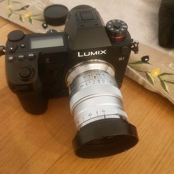

Malabito Posted December 4, 2019 Share #18 Posted December 4, 2019 I know is not what was asked, but i just got a 7artisan adapter, (cheap and seems to be of good quality), yes no 6 bit code info nor nothing, but seems to work okay.... Welcome, dear visitor! As registered member you'd see an image here… Simply register for free here – We are always happy to welcome new members! Link to post Share on other sites Simply register for free here – We are always happy to welcome new members! ' data-webShareUrl='https://www.l-camera-forum.com/topic/296417-leica-m-adapter-l-18771-with-panasonic-s1-anyone/?do=findComment&comment=3867001'>More sharing options...
