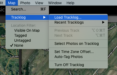

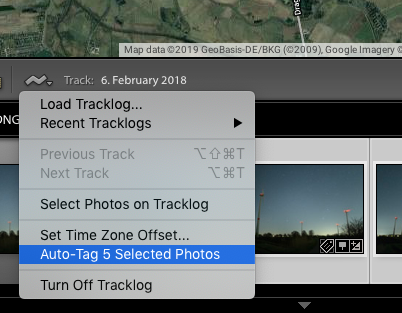

4peterse Posted April 6, 2019 Author Share #50 Posted April 6, 2019 (edited) vor 38 Minuten schrieb T.J.: Can you point me someplace to get information on how to “record the track” and then “import he track with Lightroom?” Than you! To record GPS tracks with your iPhone you can use any app that is able to produce GPX files. I'm using https://trails.io/en/ (really good: you don't need to upload anything to any cloud, it's all local on your iPhone; you can, of course, upload to Dropbox or other services, if you like) or https://www.komoot.com but there are probably hundreds of other apps. (NOTE: I'm not affiliated with any of these apps) As an example: with Trails, you export directly from your iPhone, and you can, for example, AirDrop to your Mac. With Komoot, you need to download the GPX file from their website. With the GPX file on your Mac, you can import it in Lightroom: 1. Switch to "Map" module in Lightroom 2. Load the Tracklog (the GPX file) Welcome, dear visitor! As registered member you'd see an image here… Simply register for free here – We are always happy to welcome new members! 3. Here you can adjust the timezone, if you forgot to set the time on your camera correctly… 4. Once loaded you can select the photos you like to tag in the photostrip at the bottom 5. Then you can auto-tag these photos Edited April 6, 2019 by 4peterse 4 Link to post Share on other sites Simply register for free here – We are always happy to welcome new members! 3. Here you can adjust the timezone, if you forgot to set the time on your camera correctly… 4. Once loaded you can select the photos you like to tag in the photostrip at the bottom 5. Then you can auto-tag these photos ' data-webShareUrl='https://www.l-camera-forum.com/topic/295855-leica-fotos/?do=findComment&comment=3717042'>More sharing options...
T.J. Posted April 6, 2019 Share #51 Posted April 6, 2019 Awesome description! I now have a project to work on tomorrow. Appreciate you taking the time to describe it. Link to post Share on other sites More sharing options...
