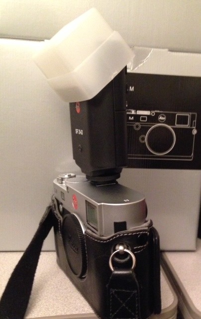

RvN Posted October 1, 2017 Share #11 Posted October 1, 2017 (edited) Agree with all that. Didn't know the 40 doesn't have A mode. I use a Metz 53MZ3 with R module, in A mode, as it picks up the ISO from the M should I happen to change it. I have Vivitars and Sunpaks that work fine but without ISO communication. Mostly though I use SF24D, also in A mode. I have an Omnibounce diffuser for the Metz which by luck happens to sit atop the 24D and makes up for the lack of a tilting head Could you perhaps show a picture of the sf24d with the omnibounce attached. I have the flash and like it. If this set-up would work like a tilting head that would be nice. Less heavy then my sf58. Also which metz omnibounce is it? Edited October 1, 2017 by RvN Link to post Share on other sites More sharing options...

bocaburger Posted October 2, 2017 Share #14 Posted October 2, 2017 (edited) Could you perhaps show a picture of the sf24d with the omnibounce attached. I have the flash and like it. If this set-up would work like a tilting head that would be nice. Less heavy then my sf58. Also which metz omnibounce is it? It sort of sits on it, doesn't really snap on, so it could possibly be knocked or fall off if you turn the camera upside down. It hasn't ever happened to me, but it wouldn't be too hard to rig something simple to hold it securely if you wanted to. Edited October 2, 2017 by bocaburger Link to post Share on other sites More sharing options...

FMB Posted October 3, 2017 Share #20 Posted October 3, 2017 For any of you interested: sf24d with the unknowen omnibounce attached. Francisco Welcome, dear visitor! As registered member you'd see an image here… Simply register for free here – We are always happy to welcome new members! Link to post Share on other sites Simply register for free here – We are always happy to welcome new members! ' data-webShareUrl='https://www.l-camera-forum.com/topic/277368-which-one-is-better-for-m240-sf58-or-sf40/?do=findComment&comment=3369384'>More sharing options...
