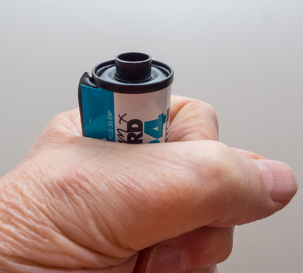

adan Posted September 13, 2017 Share #9 Posted September 13, 2017 Definitely has the hallmarks of light leaking through or around the film cassette "lips." https://2.bp.blogspot.com/-pM-_naCfZ6k/VeVo_zxr0BI/AAAAAAAAzlc/Z3GUgchwXAs/s1600/P1030268.jpg If the fuzzy-felt light traps have been ruffled, or the thin sheet-metal backing bent at all, light can get in - very fast. Since the film itself is not totally opaque, and has the sprocket holes through it, a leak can affect several layers of film (nearest the outside of the roll - thus the "first" frames of the roll) before being attenuated. And - the felt itself is not "perfectly" light-tight anyway - it is, after all, just black threads pressing on the film (or each other, when the leader is retracted). It will leak light eventually - Kentmere, Kodak, Ilford etc. count on the bare cassette being "out in the light" for a few minutes at most between unboxing and loading, and unloading and being put back in a protective wrapper/box - and all of that "in subdued light" (as the fine print on the box/instructions likely tells you) rather than raw direct sunlight. ESPECIALLY with ISO 400 film - but even with ISO 125 film: https://c1.staticflickr.com/5/4049/4512421514_9fe7d48224_b.jpg 2 Link to post Share on other sites More sharing options...
