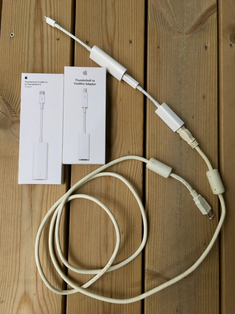

J.Nordvik Posted August 6, 2020 Share #189 Posted August 6, 2020 Today I got two new cables for Nikon Coolscan ED4000. I already had a Firewire cable for my old 2009 iMac. Three cables stacked together. Welcome, dear visitor! As registered member you'd see an image here… Simply register for free here – We are always happy to welcome new members! Link to post Share on other sites Simply register for free here – We are always happy to welcome new members! ' data-webShareUrl='https://www.l-camera-forum.com/topic/276151-beoon-advice-please-functional-checks-prior-to-purchase/?do=findComment&comment=4022691'>More sharing options...

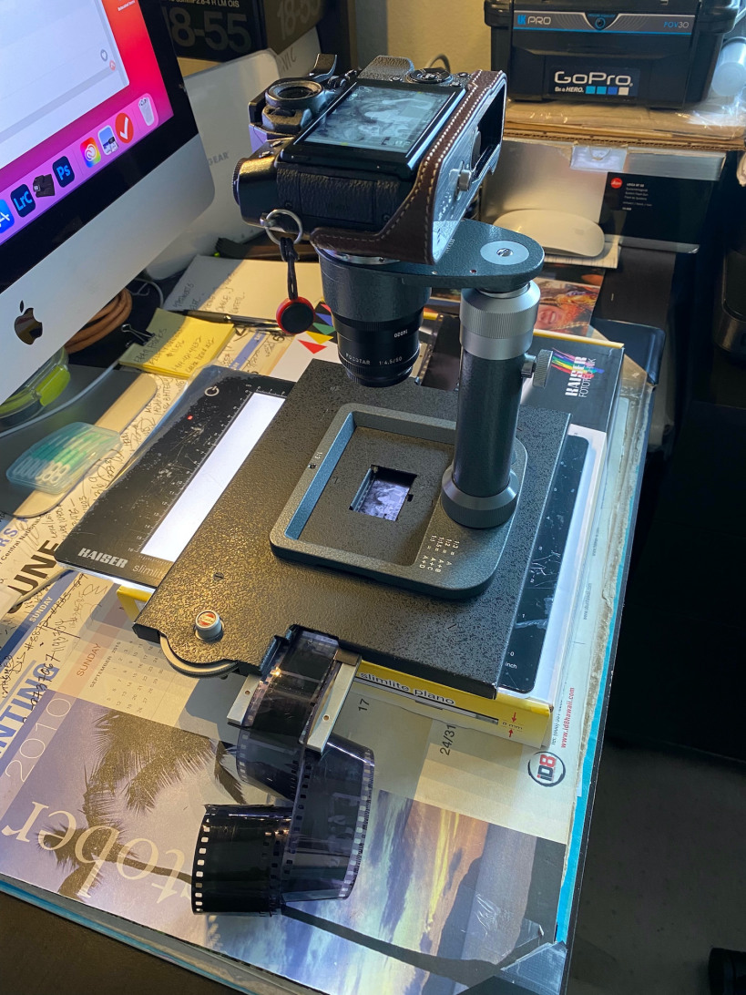

Steve Ricoh Posted August 17, 2020 Author Share #196 Posted August 17, 2020 Anyone using their BEOON to ‘camera-scan’ 6x6 cm negatives, and if so what lens are using on a Leica M? 1 Link to post Share on other sites More sharing options...

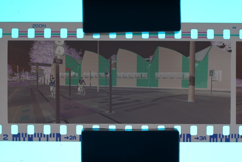

a.noctilux Posted August 17, 2020 Share #197 Posted August 17, 2020 1 hour ago, Steve Ricoh said: Anyone using their BEOON to ‘camera-scan’ 6x6 cm negatives, and if so what lens are using on a Leica M? Never use Beoon for 58mmx58mm, only pano view negatives. Maybe flatness of negatives can be problems ? I happen to scan some Xpan films, 24x65mm negatives with Beoon and 50-60mm as usual with very nice results. Most lenses would be good (or better than 1:1) for 1:2 use scanning larger negatives. Here for example with Focotar 50mm at 1:2 with Agfa Vista plus 200 ISO from Xpan negative ... two magnets to keep it flat second is detail of left part 100% view Welcome, dear visitor! As registered member you'd see an image here… Simply register for free here – We are always happy to welcome new members! 100% 2 Link to post Share on other sites Simply register for free here – We are always happy to welcome new members! 100% ' data-webShareUrl='https://www.l-camera-forum.com/topic/276151-beoon-advice-please-functional-checks-prior-to-purchase/?do=findComment&comment=4028849'>More sharing options...
ramarren Posted July 14, 2021 Share #198 Posted July 14, 2021 (edited) On 8/17/2020 at 10:16 AM, Steve Ricoh said: Anyone using their BEOON to ‘camera-scan’ 6x6 cm negatives, and if so what lens are using on a Leica M? The BEOON works best with only a very short range of focal lengths ... you can't go too far away from 50mm and stay within the physical range of adjustments available. For capturing a Hasselblad 6x6 negative (actual dimensions 56x56 mm) to 35FF format, you need 1:2.33 magnification; a little less (1:2.4-2.5) makes it easier to position the entire image area within the center of the FF format frame and capture a little of the rebate. I've done this capture using a Micro-Nikkor 55mm f/3.5 lens fitted to Nikon F->M-mount adapter on the BEOON, capturing to a Sony A7, Leica M-P 240, and Leica SL bodies. You need a lens with a macro focusing helicoid to allow getting the whole negative to fill as much of the digital capture sensor as possible; no arrangement of fixed extension rings on a standard lens that I've found works as well. An aside: the BEOON does well to capture full-frame 35mm negatives and slides with the Leica CL (APS-C format) at about the 1:1.5 setting using a 50mm lens. I've found that the Color Skopar 50/2.5 and Summicron-M 50/2 both do a very good job for this. G Edited July 14, 2021 by ramarren 1 Link to post Share on other sites More sharing options...
