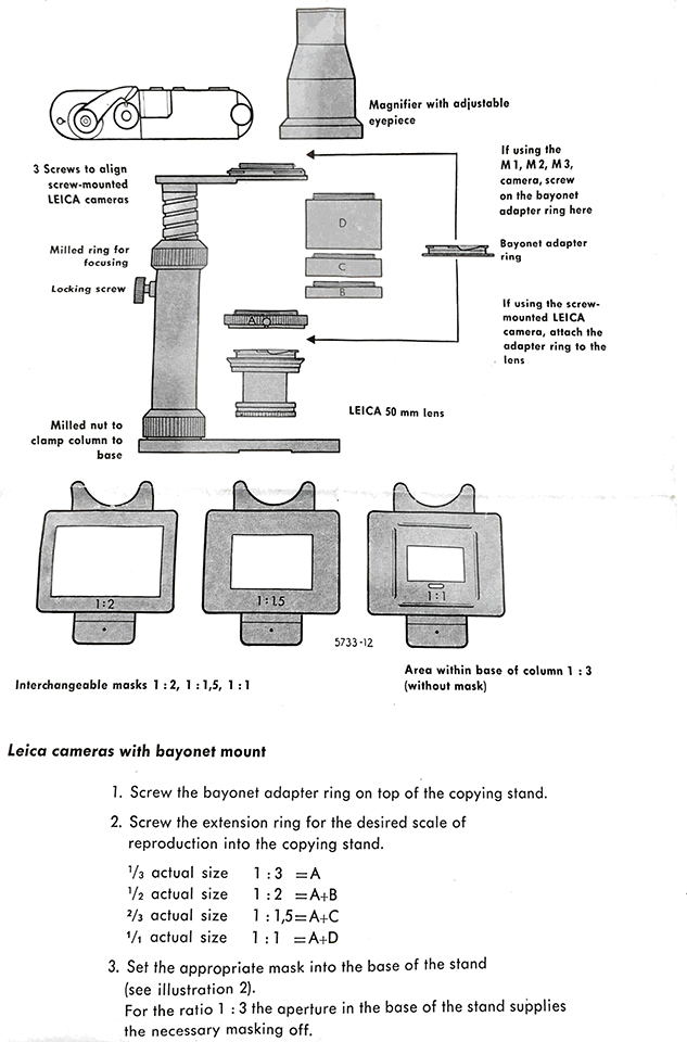

Reeray Posted August 26, 2017 Share #2 Posted August 26, 2017 It should come as a complete boxed unit. Make sure all masks (3) and M39 to M mount adapters (2) are included. Also there are 3 extensions tubes included . Other than that, it's built like a tank and little can go wrong. 1 Link to post Share on other sites More sharing options...
Steve Ricoh Posted August 26, 2017 Author Share #3 Posted August 26, 2017 It should come as a complete boxed unit. Make sure all masks (3) and M39 to M mount adapters (2) are included. Also there are 3 extensions tubes included . Other than that, it's built like a tank and little can go wrong. Thanks Reeray. Are there any alignment problems to be concerned about? I think I read somewhere (not sure where though) about play either in the post-to-base, or at the top end, resulting in erratic performance. Link to post Share on other sites More sharing options...
Reeray Posted August 26, 2017 Share #4 Posted August 26, 2017 I've bought two units in the last few months (one for a friend) and no alignment etc problems. It's just such a simple well built unit I can't imagine anything being faulty. There's a base and a screw in tower. Period. These things are 50 years old and an engineering marvel. You could drive nails with it and digitise later! Buy with confidence. 1 Link to post Share on other sites More sharing options...

UliWer Posted August 26, 2017 Share #8 Posted August 26, 2017 Perhaps this helps - though only in German: BEOON.pdf 1 Link to post Share on other sites More sharing options...
a.noctilux Posted August 26, 2017 Share #9 Posted August 26, 2017 (edited) Hidden in M8 "copies", english manual of BEOON is visible and dowloaded (for how long, I don't know): https://www.l-camera-forum.com/topic/230886-m8-and-beoon/page-2 Extract from the page Edited August 26, 2017 by a.noctilux 3 1 Link to post Share on other sites More sharing options...

UliWer Posted August 26, 2017 Share #11 Posted August 26, 2017 (edited) No, the extension ring "A" is the ring with the M-bayonet. If the knob is missing, you won't be able to fix the lens on the BEOON. Same as the knob for lens release on your camera would be missing. So stay off. You see the knob just at the position of the red dot: Welcome, dear visitor! As registered member you'd see an image here… Simply register for free here – We are always happy to welcome new members! Edited August 26, 2017 by UliWer 1 Link to post Share on other sites Simply register for free here – We are always happy to welcome new members! ' data-webShareUrl='https://www.l-camera-forum.com/topic/276151-beoon-advice-please-functional-checks-prior-to-purchase/?do=findComment&comment=3345778'>More sharing options...
a.noctilux Posted August 26, 2017 Share #12 Posted August 26, 2017 (edited) Ring "A" is the ring with M mount at one end and M39 LTM at the other end. I don't know if there is a knob, maybe the blocking/releasing button on M side. I've just try to unscrew the metal button, it came off quite easily. If that's the case, you may not able to use M mount lens. But if you plan to use M39 or enlarging lens, only for 135 or 120 negatives/slides, that ring A is not needed, on the ring marked only for 1:3 reduction use. Error, the "A" ring is used for all. My thinking not using A ring is that I use two types of Focotar 50mm lenses of different periods: one without A ring to copy 135 slides. Edited August 26, 2017 by a.noctilux 1 Link to post Share on other sites More sharing options...
Guest Posted August 26, 2017 Share #13 Posted August 26, 2017 (edited) If you use an 50 mm M-lens, you need the A + D rings for the 1:1 mask. But if you use a 50 mm enlarger lens like the Focotar 2 that I use, these have an M39 thread, in which case you use the B + C + D rings for the 1:1 mask and won't need the A ring at all. From my experience, once you use the Focotar 2 you won't want to use a normal M-mount lens on the BEOON, because the corners will be so much better. (Incidentally the manual does not refer to the use of the B + C + D rings with the 50 mm Focotar). Have a look at the BEOON manual and you'll see pictures of the A, B, C and D rings. An English version is easy to find by googling — and I believe there's also a copy on the LUF wiki. If the unit is otherwise good, except for the A ring, I would buy it. _________________ Alone in Bangkok essay on BURN Magazine Edited August 26, 2017 by Guest Link to post Share on other sites More sharing options...

a.noctilux Posted August 26, 2017 Share #16 Posted August 26, 2017 To go further to help Steve choosing one lens: - dimensions of rings: "A" is 8.47mm long "B" is 8.60mm long, "C" is 17.14mm, "D" is 34.40mm - have a note for my guiding " with Elmar 3.5/50 screw mount set to infinity, not collapsed : use B+D rings for 1:1 " - for me some flat field 50/55/60mm macro lenses can be used with adapter (the 50mm Summicron DR is NOT a macro/flat field lens, nice for distant subjects) Link to post Share on other sites More sharing options...
