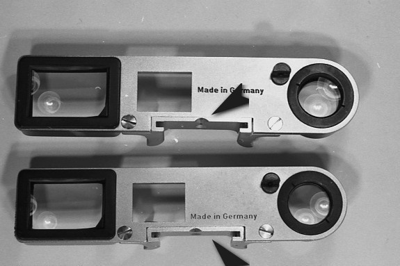

Be aware that the SDPOO was made in different periods to accept two sizes of ball.
When "big ball" goggle is used on small ball DR, this won't work.
I don't know the serial or year for each type, better knowing this "flaw" of design when buying separately.
Edited by a.noctilux
vor einer Stunde schrieb a.noctilux:
I don't know the right price now, this one is on the high price for me.
This means, i have to buy the version with the smaller version? The bottom one in the picture?
