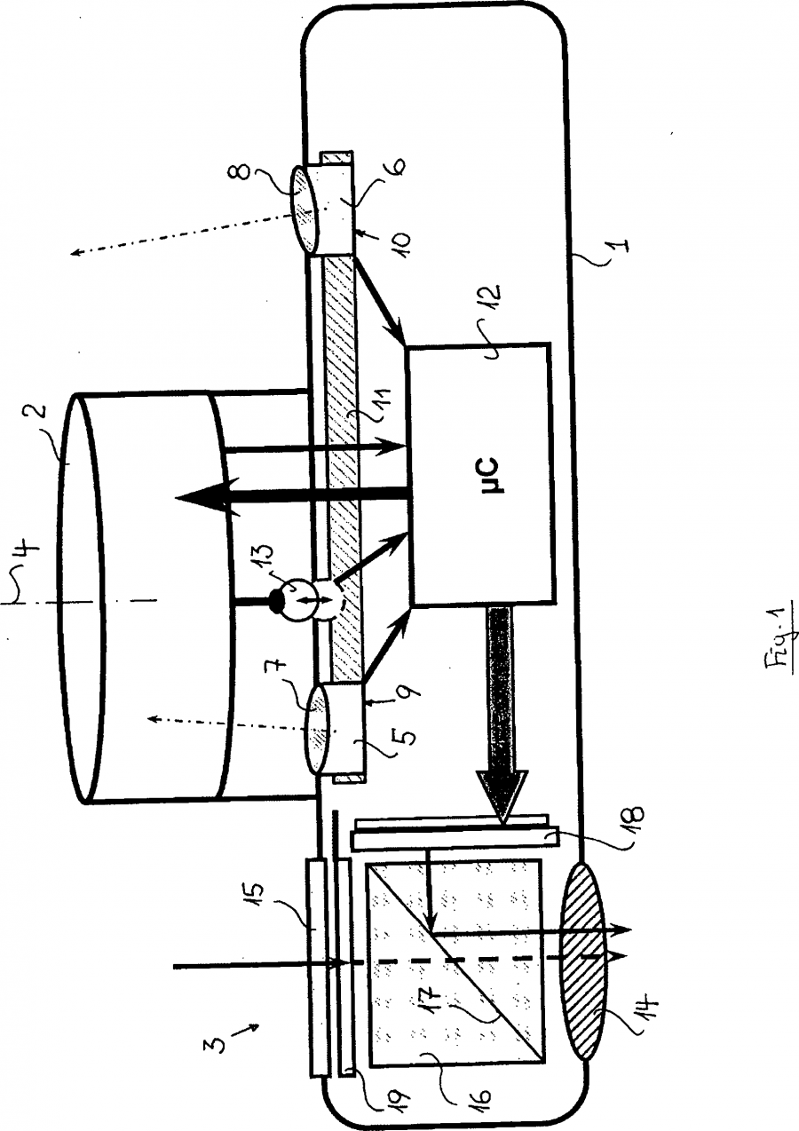

Tailwagger Posted July 9, 2016 Share #105 Posted July 9, 2016 Again, if you follow the link earlier in this thread, this is what you see. Two added optical devices and what appears to be electronic position detection of the focusing mechanism. Pretty much what you'd expect. The EVF mechanism appears to prismatically superimpose, very XPro like, the focusing view on the OVF, a notion bolstered by the fact that it s described as a hybrid mechanism. Link to post Share on other sites More sharing options...

pop Posted July 9, 2016 Share #108 Posted July 9, 2016 An EVF usually sees the image projected by the (one and only) lens of the camera, hence, through the lens. The electronic range finder described by the sketch above shows a composite image projected by two different lenses, none of them the main lens of the camera. Link to post Share on other sites More sharing options...
