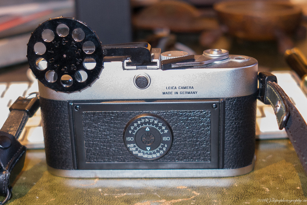

jaapv Posted March 19, 2016 Share #14 Posted March 19, 2016 Well, calculations... My reading strength is +2.25, my distance strength +0.25 (no correction needed). No astigmatism. Using a Leica Dioptre Selector, I found that the dioptre that works best for me is none. All dioptres degrade the view progressively as strength increases. Go figure. 1 Quote Link to post Share on other sites More sharing options...
